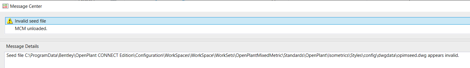

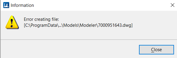

Sometimes user wants to export Dgn file to Dwg format, but he receives error for Invalid Seed File.
Reason
This is due to a missing variable in IsoProj.cfg file. We have to make changes in IsoProj.cfg file.

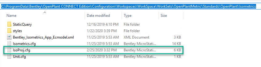

  1. Close the OpenPlant Modeler Session and navigate to below mentioned path using File Explorer.
    Path: C:\ProgramData\Bentley\OpenPlant CONNECT Edition\Configuration\Workspaces\WorkSpace\WorkSets\OpenPlantMetric\Standards\OpenPlant\Isometrics\IsoProj.cfg

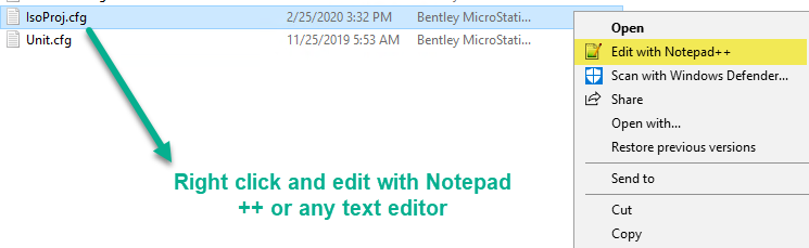

  2. Right click on IsoProj.cfg file and click to open with any text editor e.g. Notepad, Notepad ++ etc.

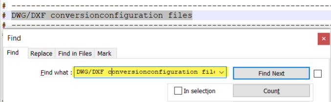

  3. Scroll in the document to find DWG/DXF conversionconfiguration files
    or
    Hit Ctrl + F and enter “DWG/DXF conversionconfiguration files” and click on Find Next.

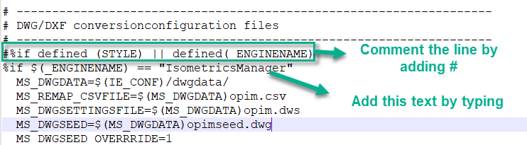

  4. Once the variable is found, add the following line in the file by entering the text mentioned below.
    To Note - Please type the expression and avoid spaces in between .
  5. Now Click on Save to save the changes and Verify the changes by exporting the Dgn to Dwg format and see the error is rectified.
