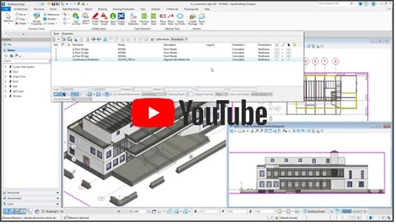

The Attach iTwin tool is a part of the Collaborate tab In OpenBuildings Designer Update 8 which brings together collaboration, synchronization, and issue resolution tools available in OpenBuildings Designer for seamless coordination between different teams on a project. Using this tool you can attach an iModel as a reference in a DGN.
Links
    •  YouTube      •  Licensing, Cloud and Web Services Wiki     •  OpenBuildings Help
