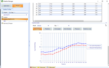

Method
To do so, go to Weather Data.
- In the top left, select Import:
- Simply browse to the file required, and select Open. Note that all of the following formats are compatible:
- This will import the weather data and the properties for the chosen file will be displayed:

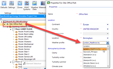

- You can then specify this in your project in Site Properties:
