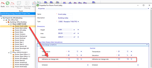

  1. Room Properties:
    Here you can enter an Infiltration Change Rate for Winter and Summer.  These values are the rooms design conditions and the winter / summer values are used in the heat loss / heat gain calculations respectively:

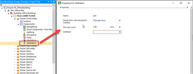

  2. Infiltration Component:
    In addition, an infiltration Component can be added - this is additional infiltration which will be considered in dynamic simulations only.
