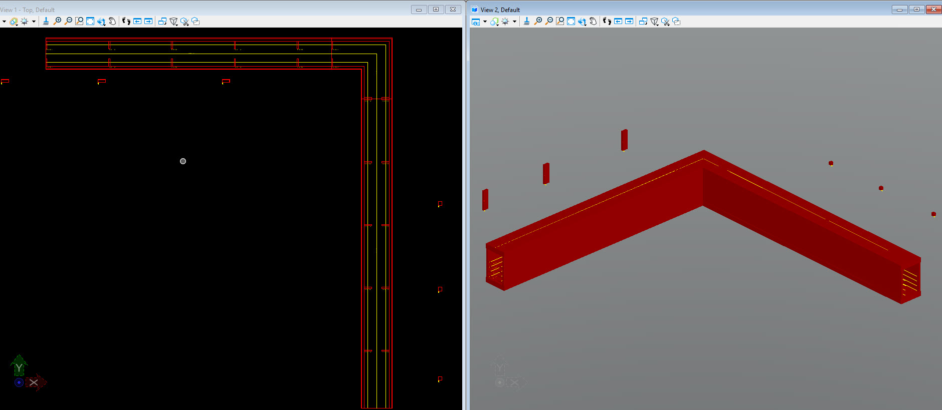

  2. For routing Trench, navigate to Underground System and click on Trench Router.
    The Trench router dialog will open. Select the desired trench settings and provide the Voltage levels to the routing lines.
    On the Right Side Supports tab click the checkbox to copy supports settings from the left side.
  3. Route the trench systems and place some equipment as explained in Step 1.

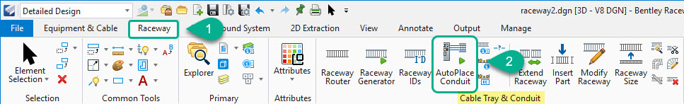

  1. Navigate to Raceway ribbon and in Cable tray & Conduits section click on the ‘AutoPlace Conduit’ tool.

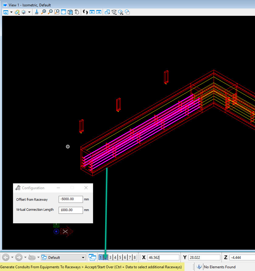

  2. The configuration dialog will open that allows you to select the:

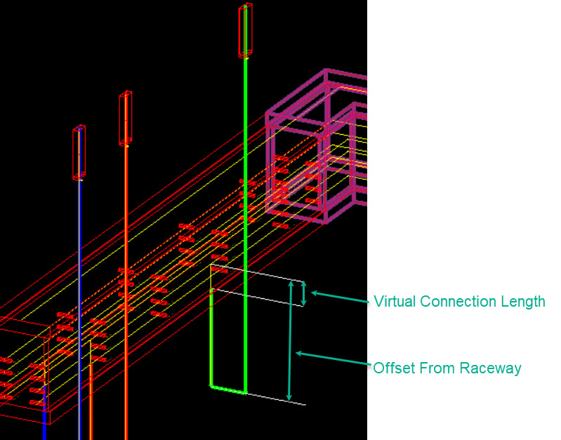

    Offset From Raceway: Vertical distance of conduit from the raceway
    Virtual Connection Length: Length of virtual connection/air gap from the Conduit to Raceway.
    Provide the desired length.
    You are prompted to ‘Select Raceways to Connect
    Select the Trench Routing lines and accept the selection by a left-click (Datapoint) and select the Equipment in the same way.

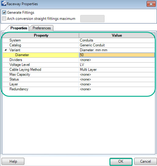

  3. The Raceway Properties dialog will open, Provide the desired conduit properties and Click OK.

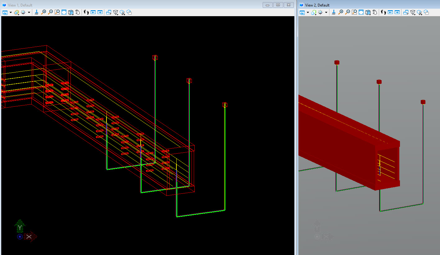

  4. Repeat the same for all the equipment and see the results.
    The AutoPlace Conduit tool will correctly connect the desired voltage level routing line of theTrench with the conduit.
  5. Observe the same results for equipment with multiple raceway layer connections.
