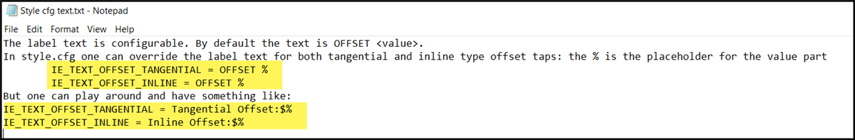

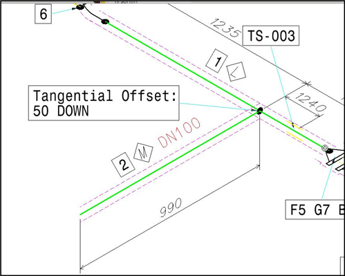

When place tapping with some offset, by default isometric not showing any information regarding tapping offset. More detail understanding tapping offset information should be required in isometric.
Following illustrative steps helps to show Labels for tapping offset.
Following illustrative steps will help to show property break in isometric.
Steps to accomplish
  1. Go to project location and select your isometric style.
            Ex: C:\ProgramData\Bentley\Plant V8i\Bentley Plant V8i Projects\SAMPLE_METRIC\Config\OpenPlant\Isometrics\styles\IFC\config
  1. Open style.cfg file. And add following entry.
    IE_TEXT_OFFSET_TANGENTIAL = OFFSET %
    IE_TEXT_OFFSET_INLINE = OFFSET %
            But user can play around and have something like:
            IE_TEXT_OFFSET_TANGENTIAL = Tangential Offset:$%
            IE_TEXT_OFFSET_INLINE = Inline Offset:$%
         3, Save the file and generate isometric to review the result.
