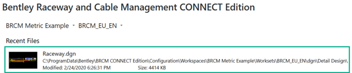

1. Launch the application and open Raceway DGN file.

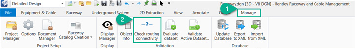

 2.The ‘Check Routing Connectivity’ tool can be accessed from the Raceway tab.
It can also be accessed from Manage tab.

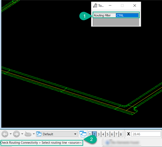

3.Click On Check Routing Connectivity , a dialog box is displayed to select the routing filter based on the assigned voltage levels to raceways. If multiple raceways are assigned to different voltage levels , by selecting the routing filter for a particular voltage level, the raceways assigned to the selected voltage level will only be displayed.

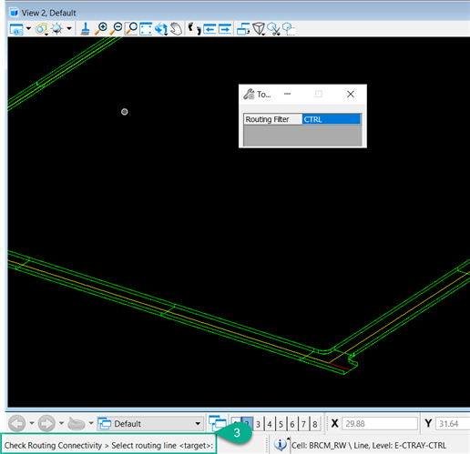

4.Select CTRL as the voltage level , and after placing a datapoint only raceways having CTRL as the voltage level will be displayed. Select the raceways between whom the connectivity is to be checked. As seen in the information at the bottom, source and target raceways needs to be selected.
Select the source raceway routing line.
Select the target raceway routing line.

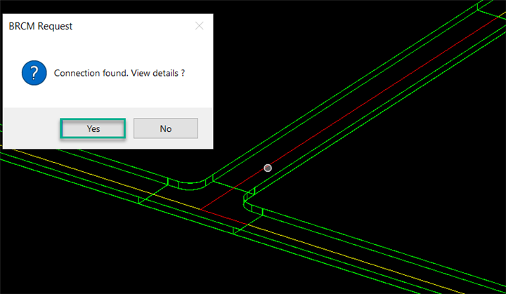

5.After selection if there is connectivity between the raceways , a dialog prompt will be displayed ‘Connection found. View Details?’ .
Click Yes to see the connection between the raceways gets highlighted in red.

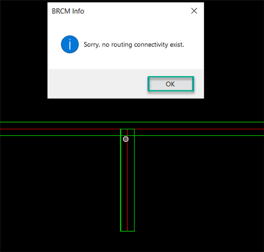

6.In some cases , the raceways might not be connected as they might not be snapped correctly.
In such cases if there is no connectivity found , a dialog prompt is displayed ‘Sorry, no routing connectivity exists.’
