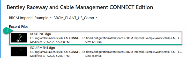

1. Launch the application and open Routing DGN file. Note: Open an already routed DGN file.

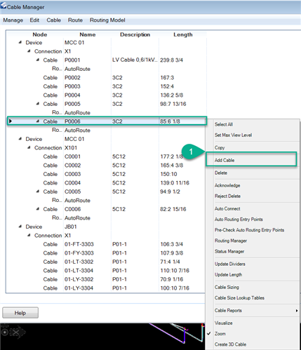

3.In the cable manager , select the last cable listed for the connection to which cable is to be added. Right click on the selected cable and select Add Cable.
Note: Add Cable option is available for the last cable listed in a connection as cable can be added only at the end of the list for a connection.

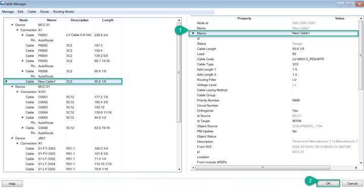

4. A new cable gets added for the connection. The cable can be renamed as per requirement in the macro property tab.
