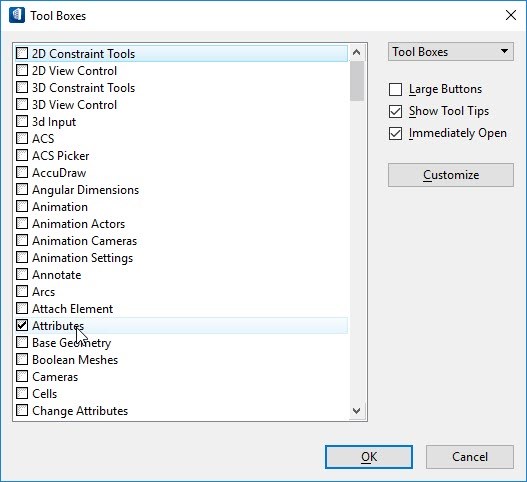

1. Go to File > Settings > User > Tool Boxes (the Tool Boxes dialog will appear), this can also be accessed by pressing Ctrl+T.
2. Toggle on the "Attributes" toolbox
3. In the Attributes toolbox right click and select the "Active Level Filter" and "Active Level" toggles
