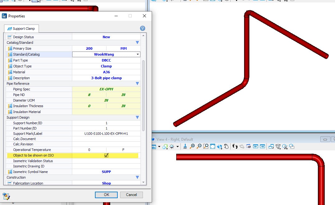

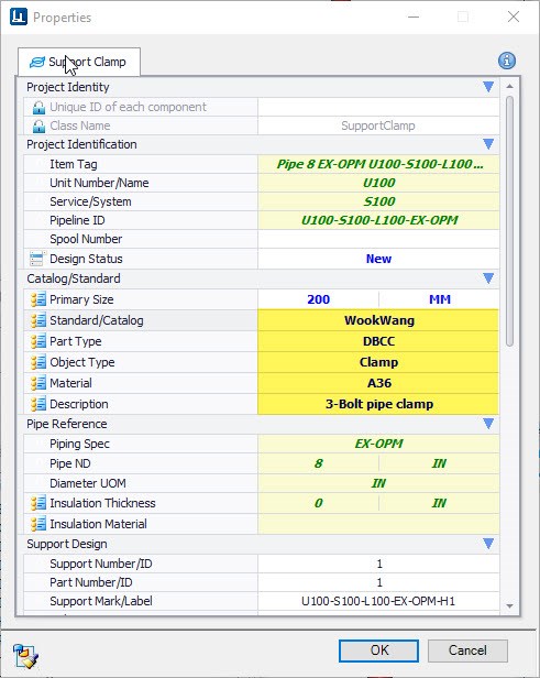

  4. From the dialog select a relevant catalog record.
  5. When this is loaded scroll down to find Object to be shown on ISO check mark. Enable it.
  6. Click OK for placement.

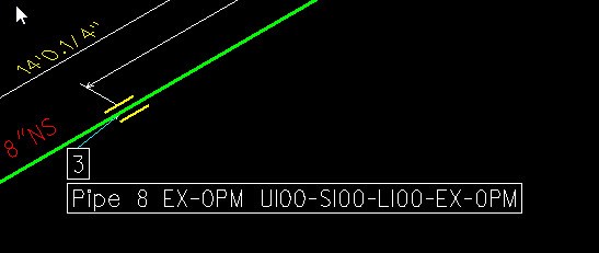

  7. Now when the isometric is generated it will contain the support.

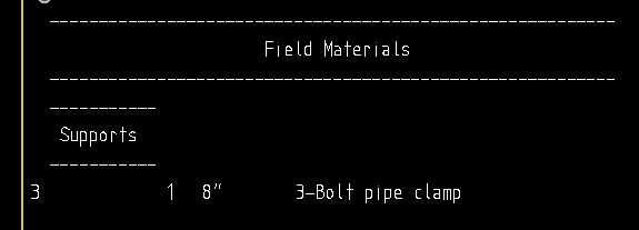

  8. One can also see that it is present in the Bill of Materials.
