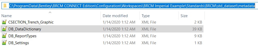

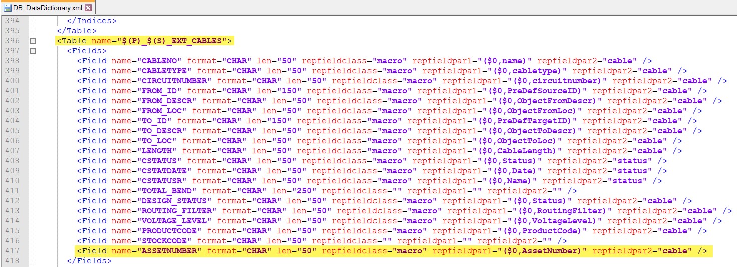

  2. Navigate to the standard dataset and open the DB_DataDictionary.xml file from the metadata folder.

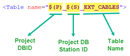

  3. This file lists the database tables. For adding the UDAs to the reports you need to edit the EXT
    The table names are defined in the XML file as follows:

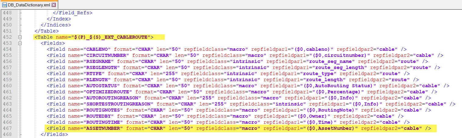

  4. See the following examples to add the UDAs to report tables.
    In this example, we are adding a Cable UDA named ‘AssetNumber’. Following are the settings:
    name: In this field provide the ID of the UDA but it should be in the CAPITAL letter
    format: Data format of the UDA value.
    len: Character length of the UDA value
    repfieldclass: Class of this field, defined as a macro
    repfieldparl1: Field parameter value to be set as ($0,UDA ID)
    repfieldpar2: The value of this parameter is set as ‘cable’ as we are adding cable UDA.
    For the Cable Schedule report: table EXT_CABLES
    For the Cable route report: Table EXT_CABLEROUTE

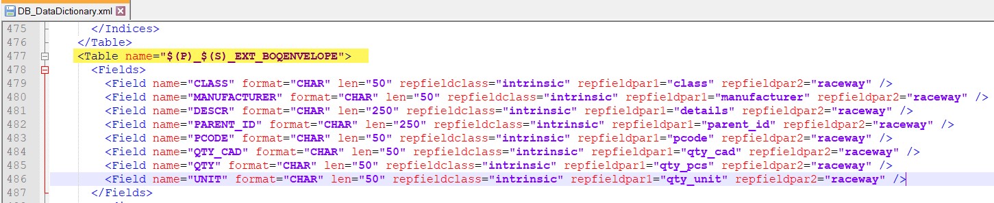

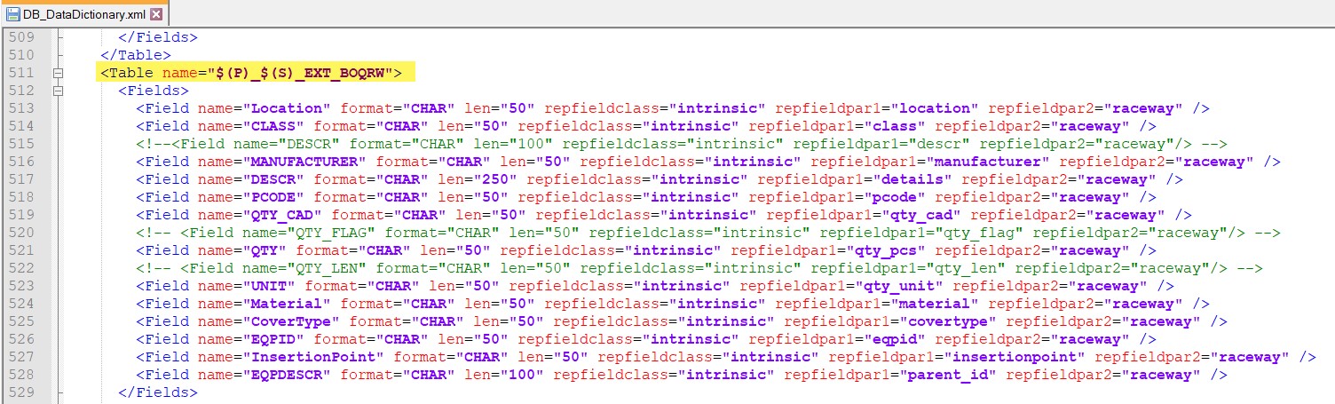

    Also if you want to add the UDA to BOQ reports you can add it using the following tables.
    For the BOQ report: Table EXT_BOQENVELOP
    For the BOQ raceway report: Table EXT_BOQRW

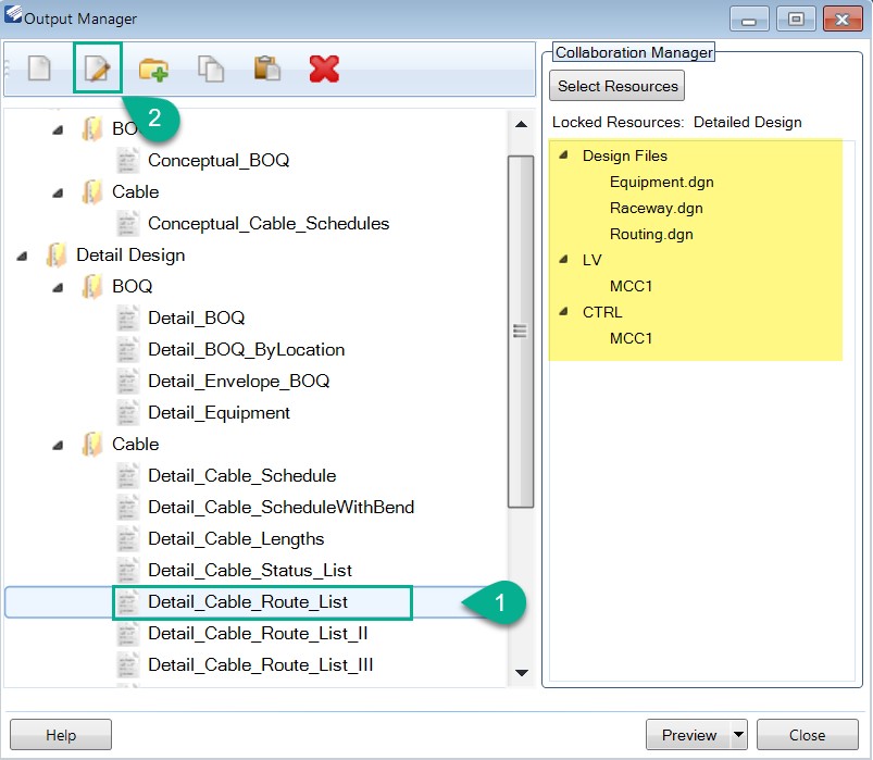

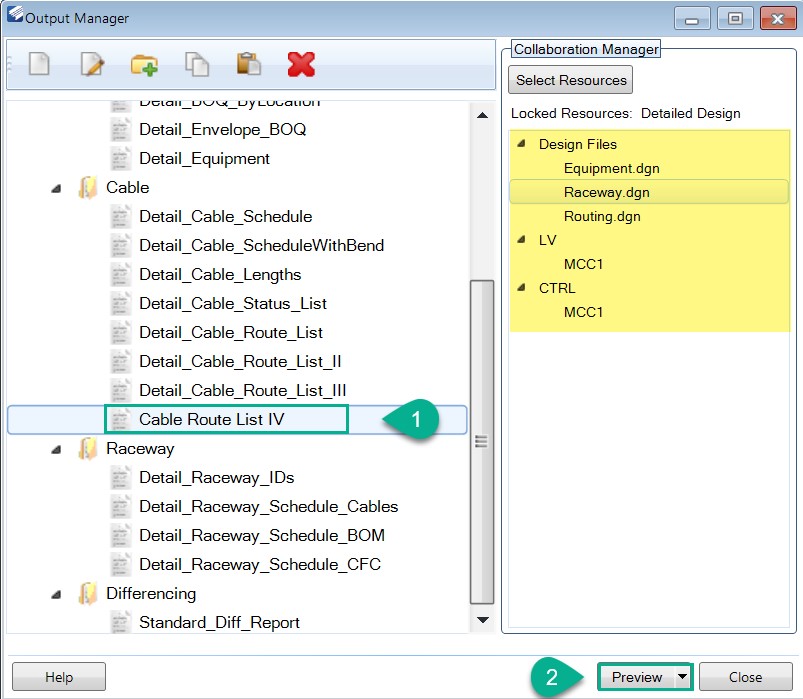

    Launch the application and open the DGN file. Navigate to the Output ribbon tab and click on Output Manager.
    Select the desired Cable report and click on Select Resources.

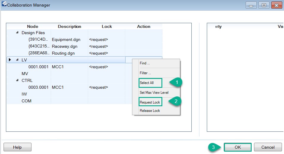

  6. Collaboration Manager will open.
    Select the required resources for the reports and click OK.

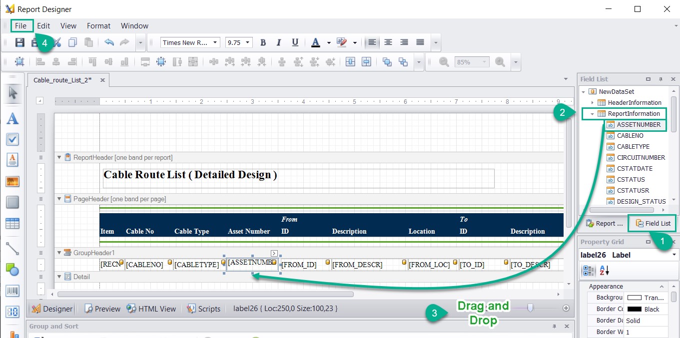

  1. In the Output Manager dialog select the report and click on the Edit Report Templet at the top.
  2. Report Designer will open. Navigate to field list and in the ReportInformation tab, you can see the added cable UDA.
    Drag and drop the UDA to the report templet ‘Details’

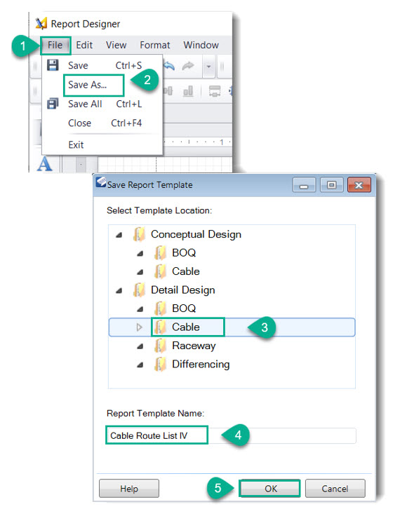

  3. You can save this report templet as follows:

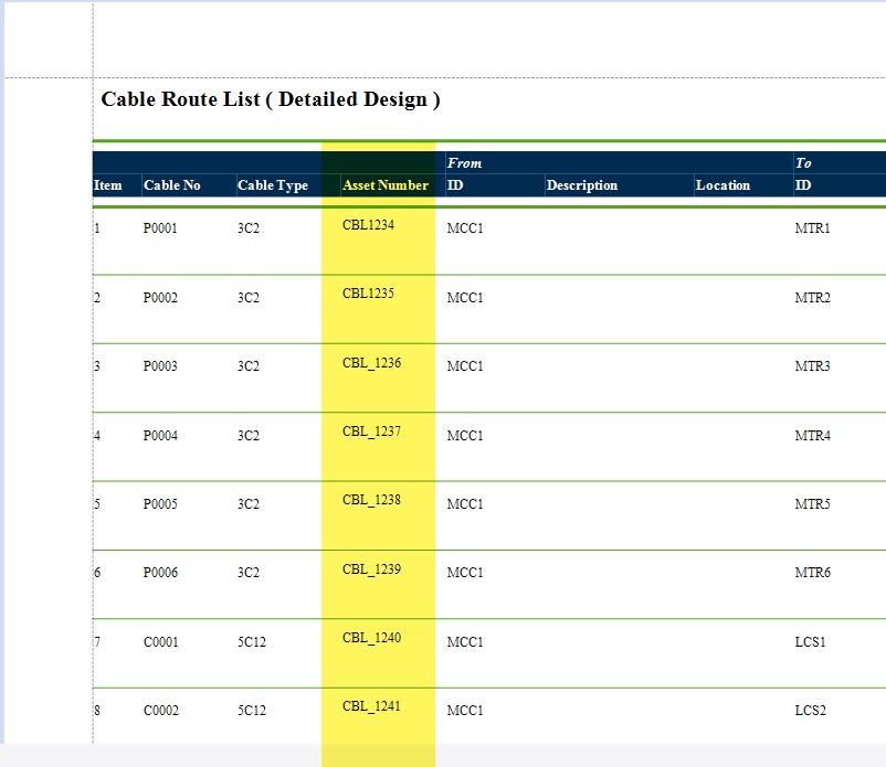

  4. Back to Output Manager, select the report and click
  5. Review the report.
