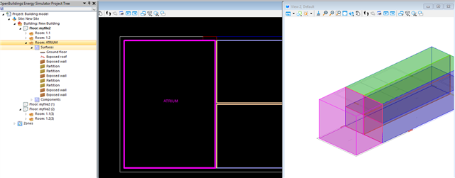

For example, take a simple two story building with an atrium entrance:

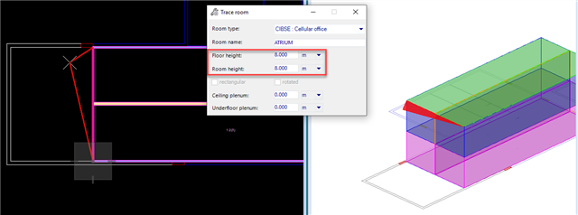

  1. In the below, the ground and first floor rooms have been traced, each 4m tall. To draw the double-height atrium, trace the room on the ground floor and simply enter the room height of 8m:
  2. When the room is complete, the software will automatically recognise adjacent rooms, independent of what floor they are on,  and will create the resultant surfaces. These adjacencies can be viewed/edited in the surface properties in the project tree.

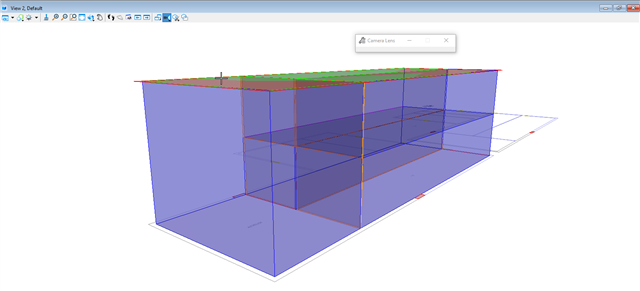

  3. Create one roof over the Atrium, and a separate roof over the remaining rooms.
  4. Doing so will allow you to Set Up Roofs accurately:
  5. This completes the model.
