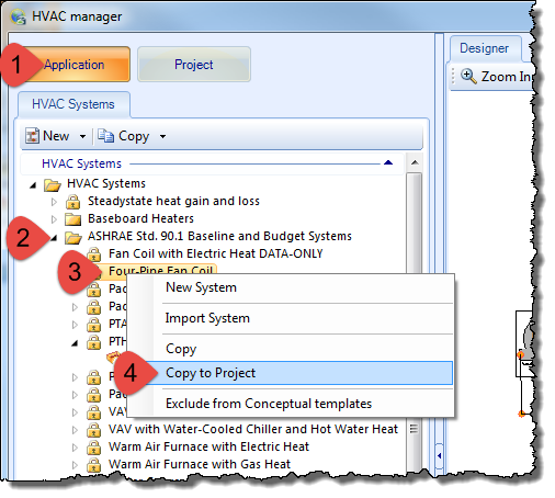

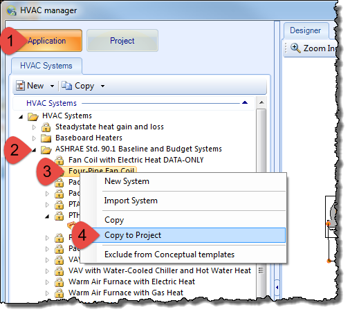

Accordingly, the systems defined in the HVAC Manager must comply with the rules of Energy Plus. You can find these prefabricated systems by selecting 'Application' in the top left corner of the HVAC manager menu. The relevant system(s) can then be copied to your Project and applied to rooms/zones as required.
An example of adding a PTAC air conditioning system, and assigning to rooms, can be found in the manual - here.

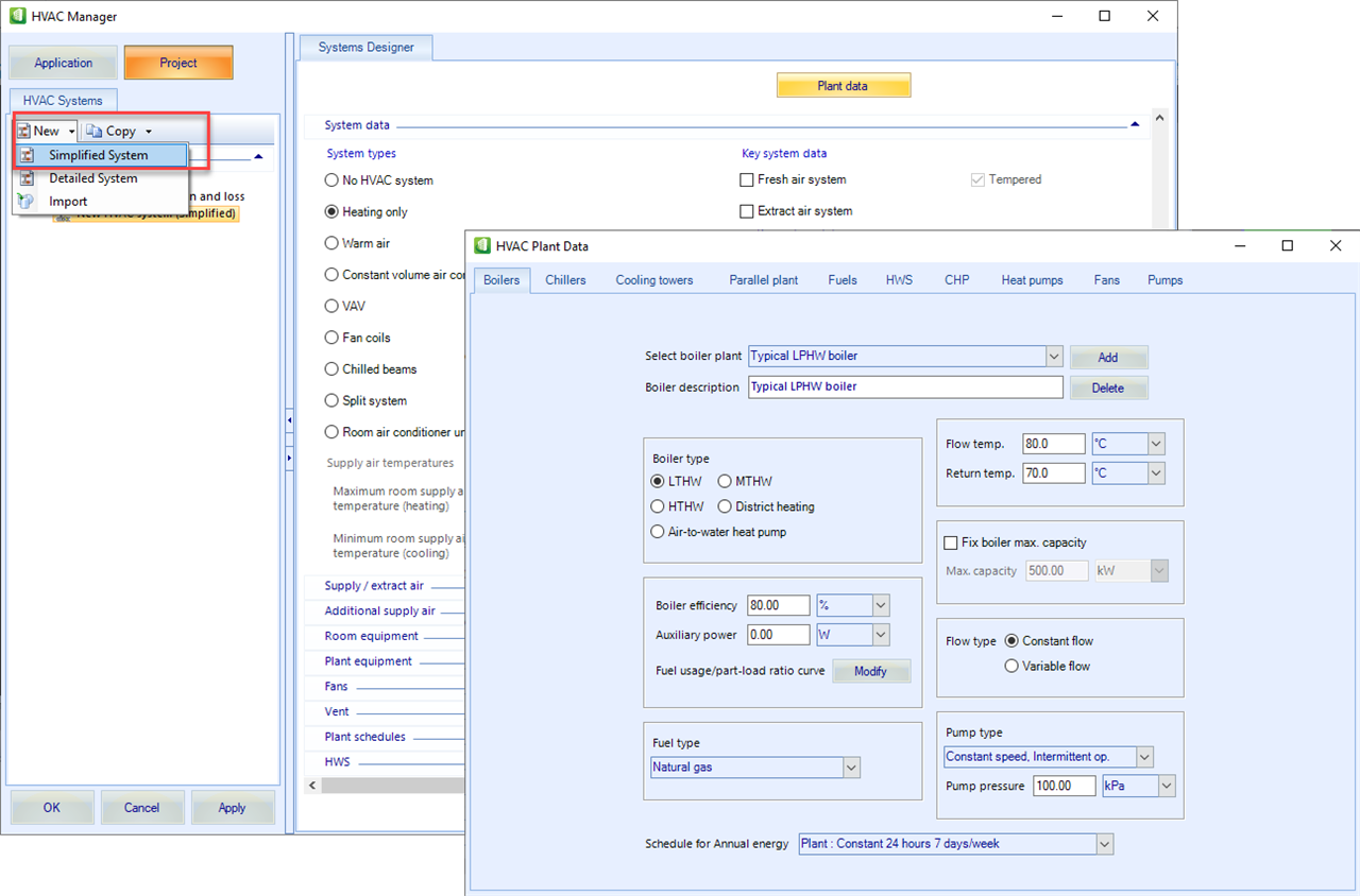

To create your own HVAC System, it is advised to use the Simplified System option:
