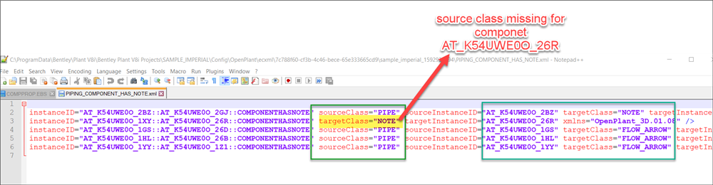

While generating isometric user may face error message “ Element ‘PIPING_COMPONENT_HAS_NOTE’ is missing required attribute ‘sourceClass’ ”
  1. Go to Project location.    For Ex: C:\ProgramData\Bentley\Plant V8i\Bentley Plant V8i    Projects\SAMPLE_IMPERIAL\Config\OpenPlant\ecxml
  2. Search for PIPING_COMPONENT_HAS_NOTE.xml file.
  3. Open in Notepad++

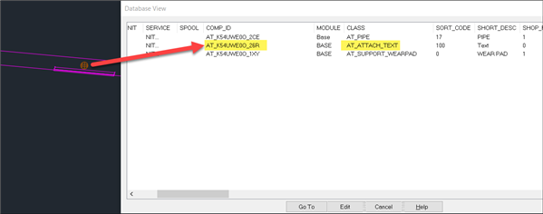

  4. Search for missing source class note down the Comp_ID
  5. Open piping model search for Comp_ID (AT_K54UWE0O_26R)
