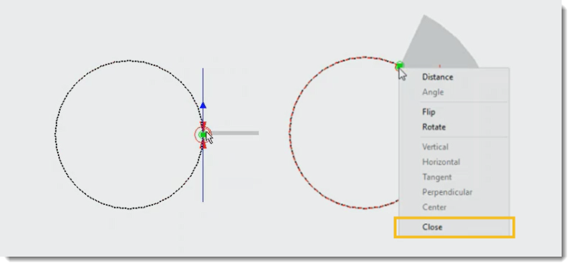

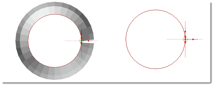

Parametric Cell Studio doesn't have a Solid by Revolution tool, so the Sweep method can be used to reflect this functionality. Care must be taken as sweeping a circular or closed path can be inaccurate.
If the sweep is not completed correctly, the solid may not be created.
This issue can be solved in a two-step workflow.
