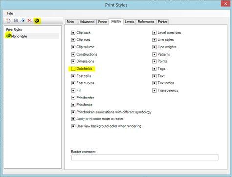

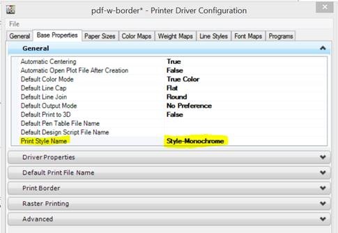

How to use a Print Style to set Print Attributes ?
There is no way to permanently set Print Attributes when you print. But you can use Print Organizer to create a Print Style to do this for you. You may want to always turn Data Fields off, always print Monochrome, and/or always Maximize the Print Area before printing. This can be done with a Print Style.
![](73025be8477d02909091861f536d432e.iix)
If the Print Style is marked as a Default Print Style it will get used every time you print whether through the Print Dialog or in Print Organizer. Look for a message stating Default Print Style loaded.
