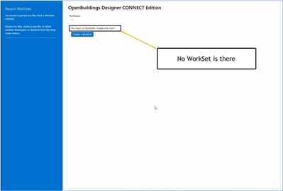

This situation commonly happens when you try to upgrade your current software from the 'Update' option in Connection Client. After upgradation when you open OpenBuildings Designer then on the opening page it is found that no ‘WorkSet’ is showing.

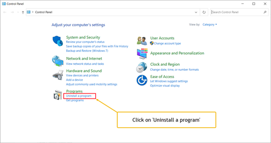

Open Control Panel and click on ‘Uninstall a program' under the ‘Program’ option,

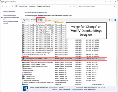

Then from the list find ‘OpenBuildings Designer CONNECT Edition’ and click on it. Then choose the ‘Change’ option.

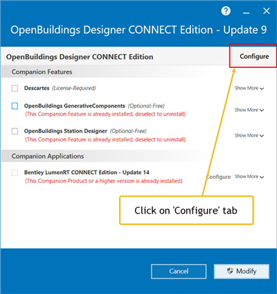

Then when this dialog will pop up click on the ‘Configure’ tab,
Step-4,

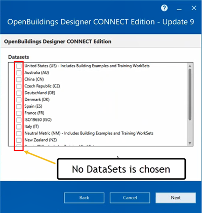

When you will reach ‘DataSets’ page there you will find that no DataSet is chosen.
Then chose your required DataSet (here we choose ‘United Kingdom (UK)’ for example’). Then click on ‘Next’ and ultimately click on ‘Modify’.

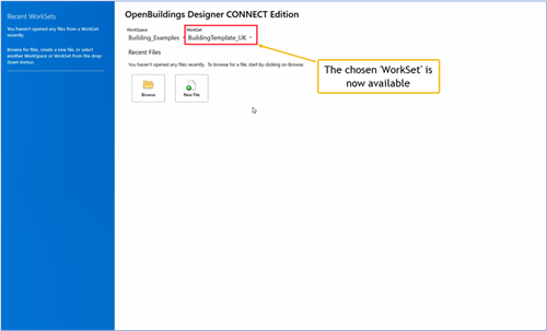

When the software modification will be finished then try to open OBD. There you can find that your chosen DataSet is there,
