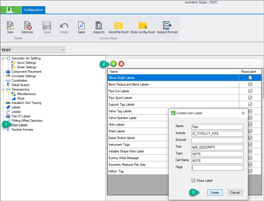

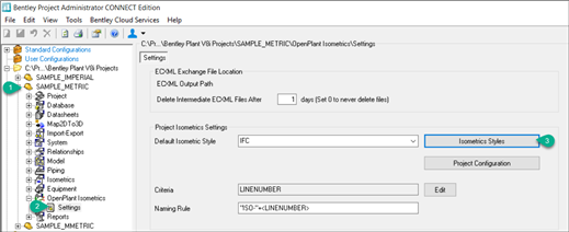

1.Open Project Administrator.
2.Open Isometrics Configurations drop down window as per below steps.

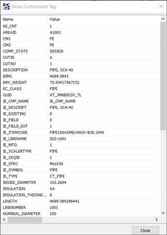

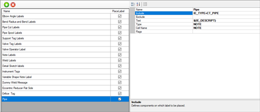

3.Under ‘User Label’ tag Enter the data with steps 1,2,3, as shown in image below. Assign all the value of component attribute. Selection of the expression IE_TYPE should be done carefully to get it appear in isometrics. This can be checked and confirmed from the component tag list shown in this step later.

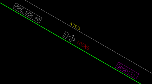

4.Click ‘Save’ and generate the isometric, the IE_DESCRIPT value will get displayed. See image below. (IE_DESCRIPT value has been taken for reference).

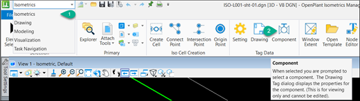

Note: User can also set the other component attribute value in User label dialog as per requirement. To get the component attribute information see image below for reference.
