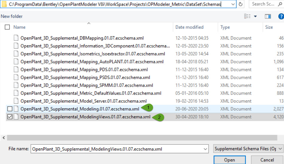

  1. Launch Bentley Class Editor,Open OpenPlant_3D.01.07. ecschema.

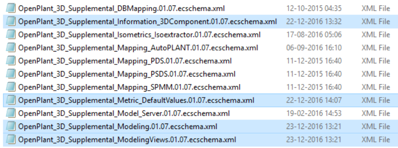

  2. Supplement with below highlighted schema as shown.
    Path: C:\ProgramData\Bentley\OpenPlantModelerV8i\WorkSpace\Projects\OPModeler_Metric\DataSet\Schemas
     For More information on supplementing schemas click here>>>>

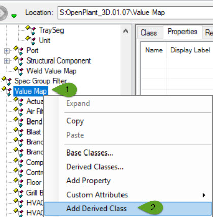

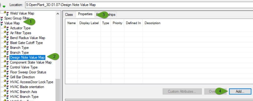

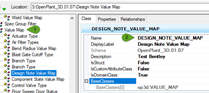

  3. Navigate to value map class, right click on it and select Add derived class.
  4. Create a new class name, say See image below:

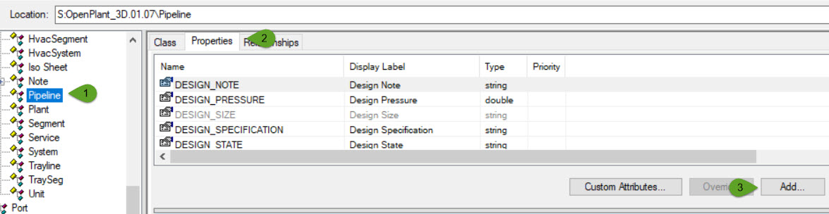

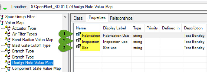

  5. Switch to Properties tab and add few properties which should be present while assigning to Property attribute in drop down selection. See image below:

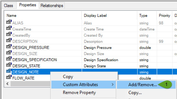

  6. Navigate to Pipeline class and add property DESIGN_NOTE in it like shown in image below.

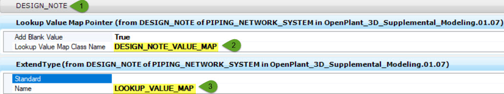

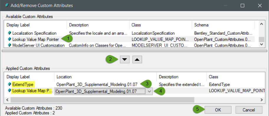

  7. Right click on DESIGN_NOTE property -> Custom Attributes --> Add/Remove.
  8. Select Custom attributes, ExtendType and Lookup Value Map Pointer from dialog box shown below and assign location to schema shown in image.
  9. Enter the value as shown in image below. This will map the new Value map class defined and explained in above steps.

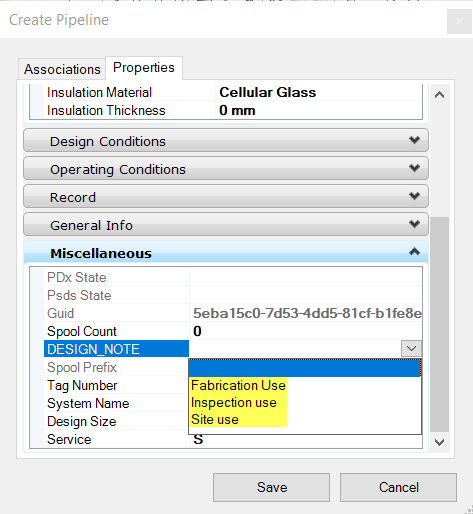

  11. Launch OpenPlant Modeler.
  12. Select Create Pipeline and verify result. Notice Dropdown for Property DESIGN_NOTE holds the value.
