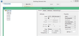

1. 3D solids may not respond to a fill override because they are often composed of linear elements, where the concept of a fill does not exist. For example, using Building Element Info we can see that the default structure for Primitive solids such as Slabs or Extrusions is shapes with connecting lines between them:

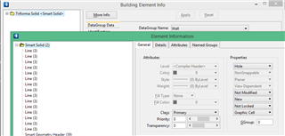

The underlying structure of a Smart Solid is entirely composed of linear elements such as lines.

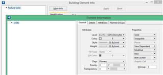

While Feature Solids are Type 106 elements:
When modifying a Primitive solid by adding a cut or chamfer, or using the Convert To Solid command, the Primitive solid is converted into a Smart Solid and so the underlying structure is changed to linear elements.

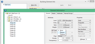

2. Forms, such as Walls, Slabs, Free Forms, etc., are composed of shapes, but those shapes do not have fill enabled.
When adding a cut or opening the underlying structure remains the same but fill is still not enabled.
So in order for a Form to respect a fill setting you would have to change each individual shape's fill value from None to Opaque which can be accomplished using Building Element Info.
If a Form is modified by adding a feature such as a Chamfer or Fillet, or otherwise converted into a Smart Solid, then as noted above the underlying structure will be composed of linear elements which cannot have a fill applied.

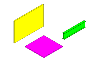

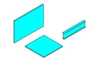

- These are the native element colors for a Wall, Slab and Beam, in this case yellow, magenta and green, shown using the Display Style "Illustration With Shadows".

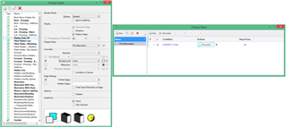

- This is a custom Display Style that sets Element color to Cyan and Edges color to dark grey with lineweight 2 (different than element color).

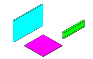

- This is another custom display style that uses the same Edge setting as SMOOTH2 but no color override, but it also includes a Display Rule where "Is Wall" is defined as the Condition and Display Style SMOOTH2 is defined as the Action.
The end result is that only the Wall element displays as Cyan but with the same Edge settings as all other elements.
