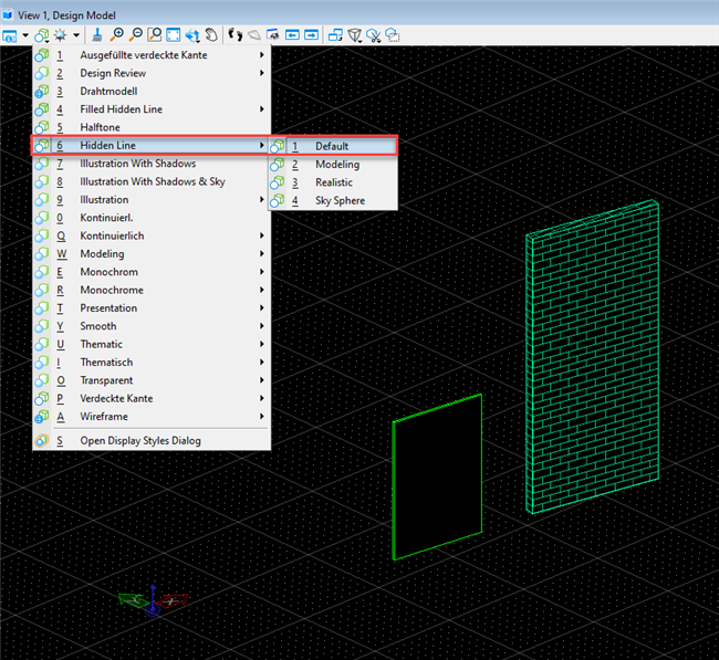

How to display a hatch or pattern in a 3D Model or 2D drawing using a Part’s assigned rendering mate
Version(s):CONNECT Edition
Area:Drawing Views
Subarea:Geometry Maps
I have two walls with different parts assigned, each using a different material.  But only one displays a pattern in the 3D model when using a Hidden Line display style or in my 2D drawing.
This can be accomplished by assigning a Material to a Part and a Geometry Map is assigned to that Material.
