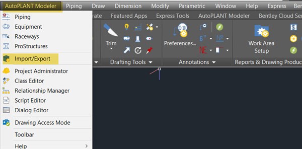

1. How to generate isometric: Isometric can be generate following ways.
      A.1. Open Piping and Equipment drawing.
      A.2. Go  to AutoPLANT Modeler > Import /Export
      A.3. Select Generate Isometric option.

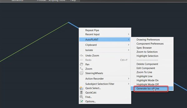

     B.1. Right click on Pipe and Select AutoPLANT >Generate Iso of Line

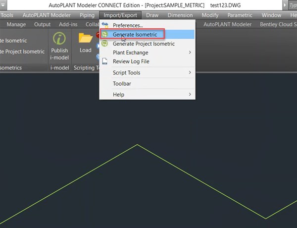

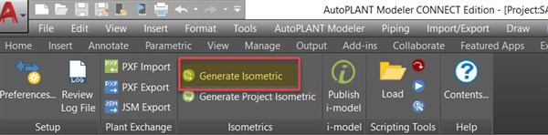

      C.1. Open Piping and Equipment drawing.
      C.2. Go  to AutoPLANT Modeler > Import Export
      C.3 Select Import/Export > Generate Isometrics

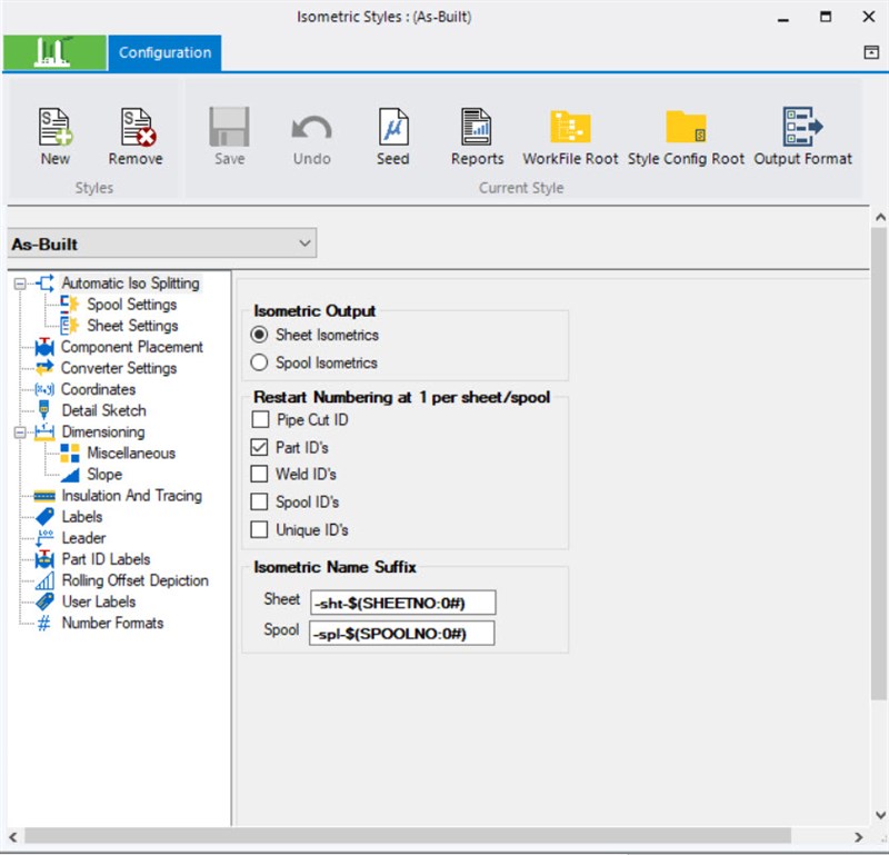

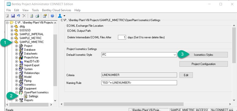

2.  How to change or Modify Isometric settings :
  1.      Open Project Administrator.
  2.      Select desired project. OpenPlant Isometrics Manager >Settings > Isometric Style
