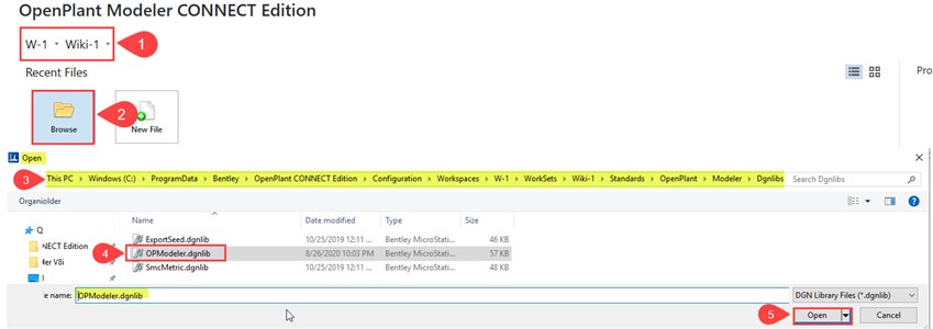

  1. Launch OpenPlant Modeler CONNECT Edition.
  2. For the desired workspace, open the OPModeler.dgnlib from the highlighted location below
  3. Change the workflow to the Admin from top left corner as shown

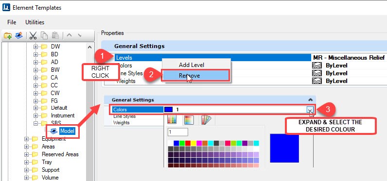

  4. From Home > Collections, open Element Templates as shown

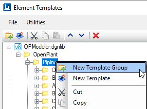

  5. Expand piping node, right-click & create new template group as shown
  6. Enter the desired name for the created template group as shown

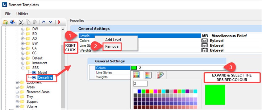

  7. Right-click to the newly created template group (SBS) & create a new template as Model. Remove the level & select the color as shown below

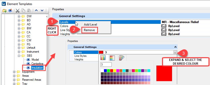

  8. In the same manner, create two new templates as Centerline & insulation. Also repeat the point 1,2 & 3 as mentioned above.
    For Centerline
    For Insulation
  9. From utilities, update the templates as shown

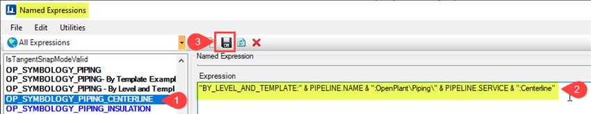

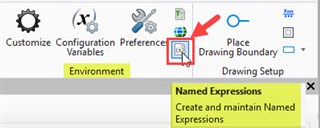

  10. From Home > Environment, open Named Expressions, refer image below

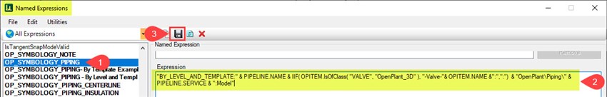

  11. Scroll to down, search for OP_SYMBOLOGY_PIPING & paste the expression mentioned below & save.
    Expression :- "BY_LEVEL_AND_TEMPLATE:" & PIPELINE.NAME & IIF( OPITEM.IsOfClass( "VALVE", "OpenPlant_3D" ), "-Valve-"& OPITEM.NAME &":",":")  & "OpenPlant\Piping\" & PIPELINE.SERVICE & ":Model"
  12. Similarly, update the expression for OP_SYMBOLOGY_PIPING_CENTERLINE as mentioned below & save.
    Expression :- "BY_LEVEL_AND_TEMPLATE:" & PIPELINE.NAME & ":OpenPlant\Piping\" & PIPELINE.SERVICE & ":Centerline"

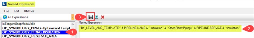

  13. Same way, update the expression for OP_SYMBOLOGY_PIPING_INSULATION as mentioned below & save.
    Expression:- "BY_LEVEL_AND_TEMPLATE:" & PIPELINE.NAME & "-Insulation" & ":OpenPlant\Piping\" & PIPELINE.SERVICE & ":Insulation"

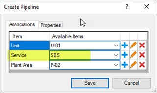

  15. Create the pipeline with service name SBS as shown

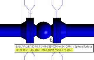

  16. Place a pipe & valve of desired size & the changes done are as follows
    For Model
    Notice that, the color is changed & the valve tag is added in level.
