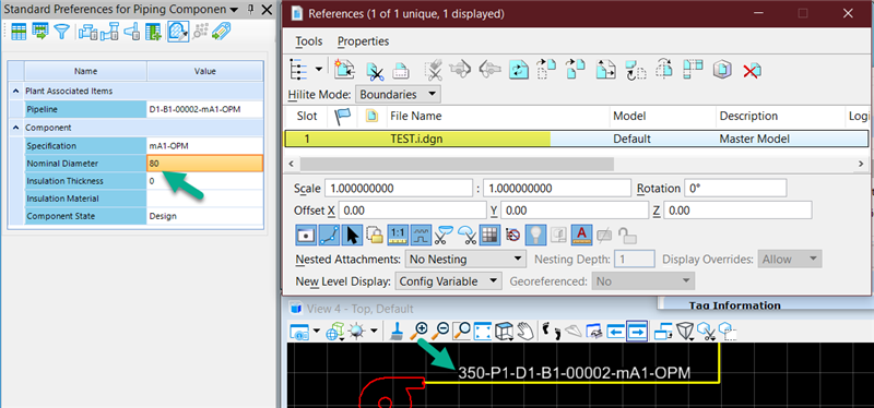

There has been issues where if i.Model of OPPID SS6 or SS10 is attached to OPM CE then in Standard Preferences dialog box Plant Associated Items gets updated except  Size of Pipeline hence this wiki will help in resolving t it.

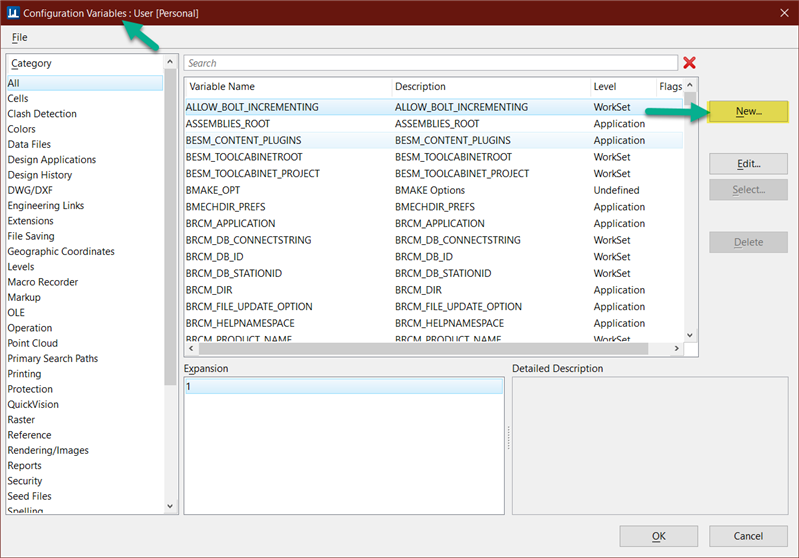

  2. In the attached i.model dgn launch Configuration Variable either through search option or through File→Settings→ Configuration → Configuration Variable.
    After launching Configuration Variable dialog box, Click on New icon

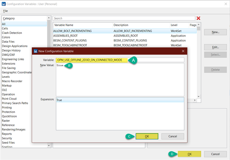

  3. In New Configuration Variable dialog box type in ,” OPM_USE_OFFLINE_2D3D_ON_CONNECTED_MODE “, in Variable and “True” in New Value as shown below and hit on Ok twice to save.
    Priorly Verify : OPM_USE_OFFLINE_2D3D_ON_CONNECTED_MODE- True in Configuration variable search option if it already exist.

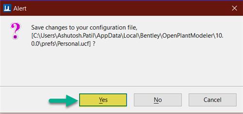

  4. Clicking on ok and then in Alert dialog box hit on yes to save the changes in Configuration File.
  5. Restart the OPM CE and reattach the i.model to new dgn.

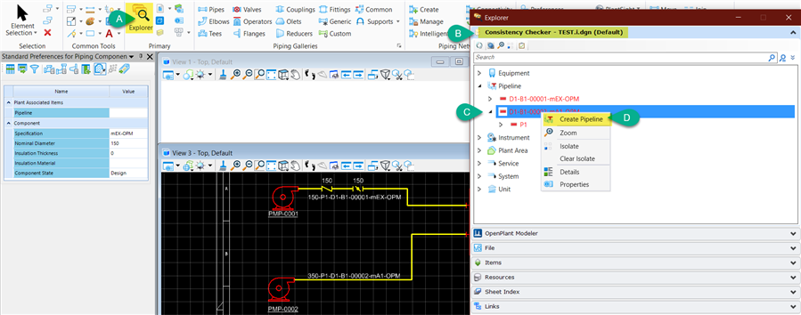

  6. Consistency checker get enabled after attaching i.model through Explorer.Expand the Pipeline section to place the desired pipeline Number and right click on it.
    It can be noted that since Associated Items are not defined Pipeline value in Std preferences is empty.

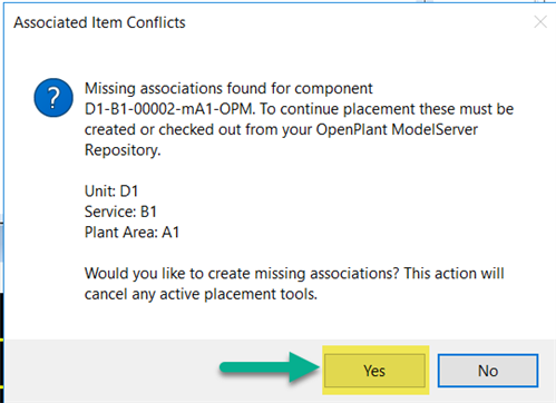

  7. Associated Item Conflicts dialog box gets launch which explains about missing associations item and need to be created.Hit on Yes.

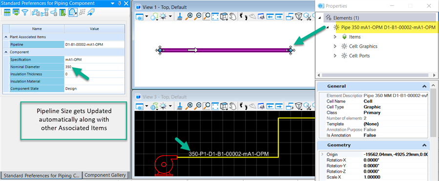

  8. Hitting on yes the Associated Item defined in Pipeline No gets updated in front of Pipeline in Standard Preferences dialog box and then Pipeline size also gets updated.
    Thus resolving the issue of Pipeline Size getting updated from the default one in Standard Preferencs Dialog after adding variable in OPM CE.
