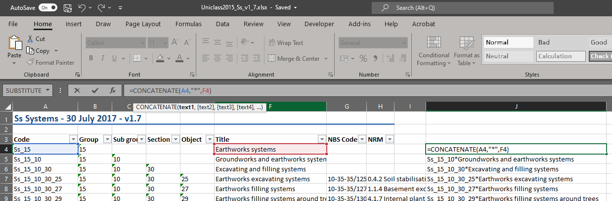

To do this a table containing the specification code and short description must be generated from the appropriate source exported in a structured format (XLS, CSV…). In this example we will use the UK's Uniclass Systems table, provided in Excel format by the NBS.
The SPC file is a text file containing a structured list. Each Keynote requires an line in the format:
<Code>*<Description>
These can be generated from Excel using the CONCATENATE operator:
e.g.: =CONCATENATE(A4,"*",F4)
The cells can be selected, the asterisk is inserted by adding
Once the first field is populated just drag and fill to create the list.

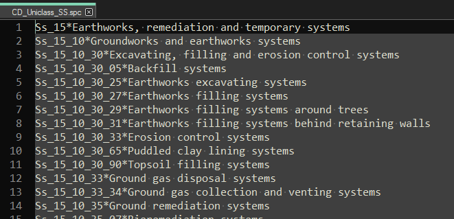

Copy and paste the list into a empty text file with the SPC extension (just create a text file and modify the extension, ensure Windows File Explorer is displaying extensions).

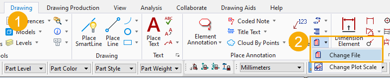

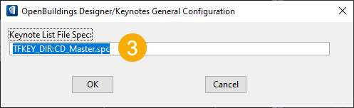

Select the file using the Change File tool
The file name must be typed in, there is no browse function in this dialog.

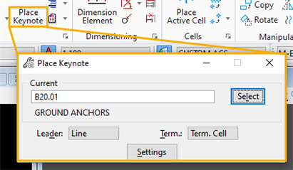

Placement
Follow the guidance in the help documentation.
