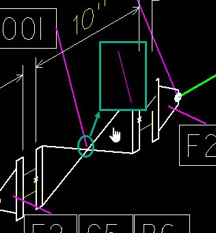

In OpenPlant Modeler CONNECT Edition, the requirement is to disable the terminator of the leader line in isometric via OPIM CE.

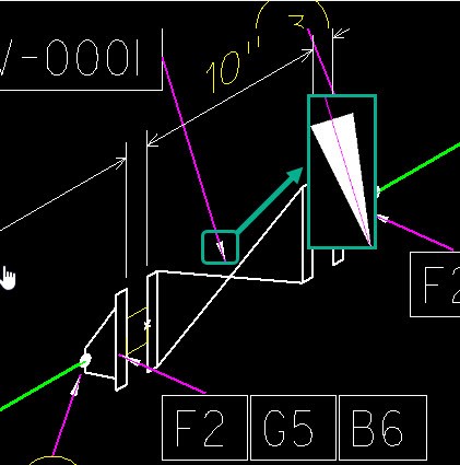

In OpenPlant IM CE, a new tool has been introduced to disable the terminator of the leader line. By default, the terminator for a leader is shown as attached in the snap below

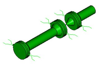

  2. Select the desired workspace & workset from the interface, Place a pipe & flange arrangement with the blind flange at the end as shown

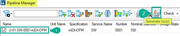

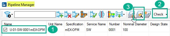

  3. From pipeline manager, select pipeline, choose the required isometric style (here CHECK) & auto-generate the iso-sheet as shown
  4. Again, select pipeline & generate iso as shown

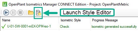

  5. Once done, the OpenPlant Isometric Manager interface will open. Launch style editor as shown

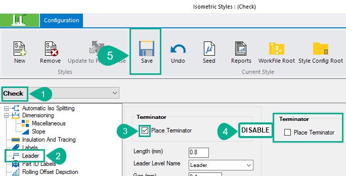

  6. Select the style as a check, move to leader settings & disable the terminator as shown & save.

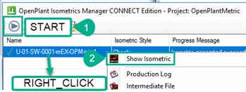

  7. Click on start. Once done, do right-click & select show isometric as shown
  8. Once the isometric is opened, verify the results as below
    As shown, the terminator for the leader line is disabled now.
