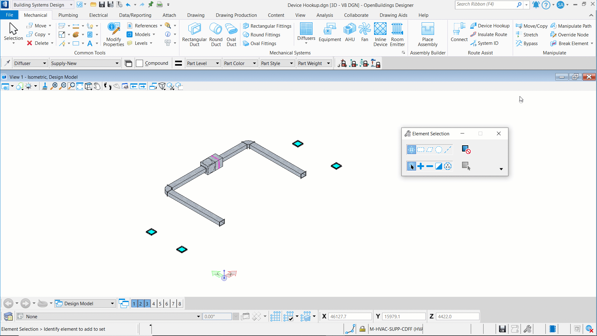

Hook Up Tool (Enhanced Tool):
- The Hook Up tool has been re-written to improve upon the existing tool and add more capability, this tool offers automated options on hook up routing and increases stability of the tool. This tool is now available within the ribbon interface rather than as a stand-alone dialog box. Fittings generated during hook-up process are based on user defined auto-fitting preference settings.
- Hook Up options:
- Calculated:
- User will be presented with calculated routes that are based on the optimized paths. There may be multiple options to choose from that are shown in single line dynamics, user can toggle through these options and accept preferable solution. These solutions include both side connections to the nearest face or top/bottom duct connections based on orientation.
- User defined settings like angle, flex length and item type will be incorporated in the calculated solution paths
- Free form:
- Similar to previous functionality, user can dynamically manipulate the hook up route by cursor movement that is reflected on screen with single line path representation.
- Hook Up settings:
- Selection set: Multiple terminal devices can be selected so that hook up takes care of multiple connections, this capability replaces the need to use Fence in the previous tool.
- Group: This functionality enhances the use of selection sets to let the user visually see and manipulate the single line path to adjust how a group of terminal devices are connected to the piping or duct system. This allows the user to adjust how and where branch take-offs and subsequent final connections are made, note that this capability can only achieve results with 90°connection angles.
