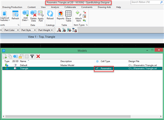

1. Open the Cell Library containing your Parametric Cell and navigate to the applicable Model:

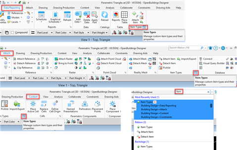

2. Open the Item Types dialog from the Data/Reporting, Attach or Content tabs, or use the Search Ribbon field:

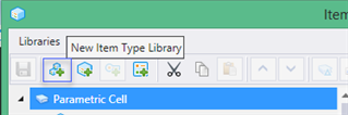

3. Select the desired Item Type Library (Parametric Cell in this example) or create a new one if needed:

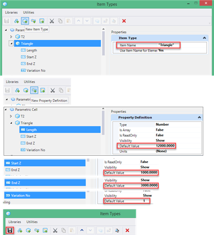

4. Create a new Item Type (Triangle in this example), new Property Definitions for each variable to be used in your Report, assign a Default Value to each, then click on the Save button:

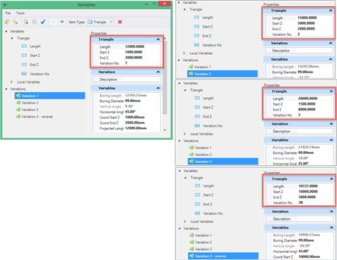

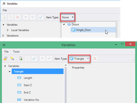

5. From the Constraints tab open the Variables dialog and select your Item Type:
6. Click on each Variation and enter the required Item Type values:

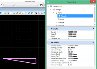

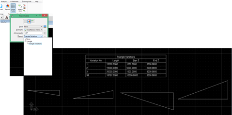

7. When a Variation of your Parametric Cell is placed within a DGN file its associated Item Property Definition values are also included:

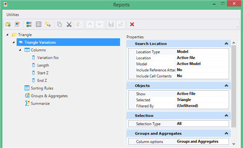

8. These Item properties can then be used by the Reports tool, and a table placed in the file:
