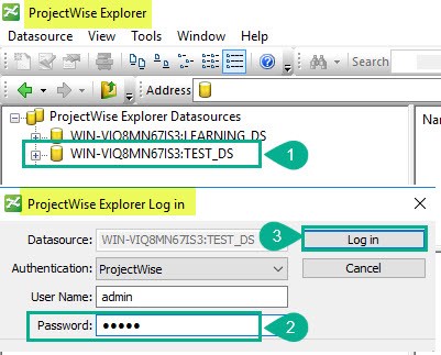

  2. Double click on the desired data source & log-in with the appropriate password as shown

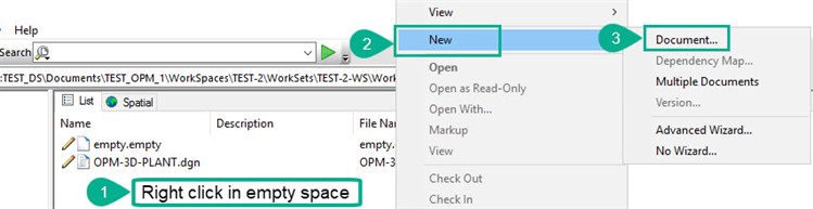

  4. Right-click on the empty space & create a new document as shown

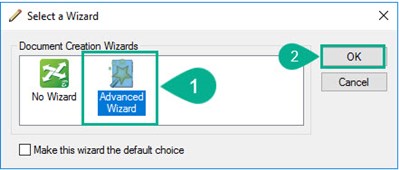

  5. Select advanced wizard from the wizard dialogue & hit ok as shown

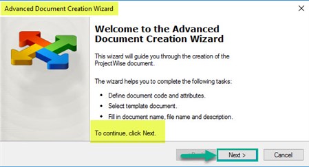

  6. Once done, the Advanced document creation wizard will pop up. Hit next as shown

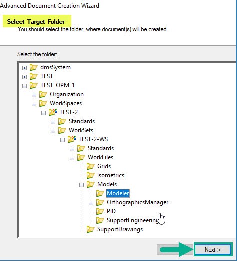

  7. Select the target folder in which file to be created & click on next as shown

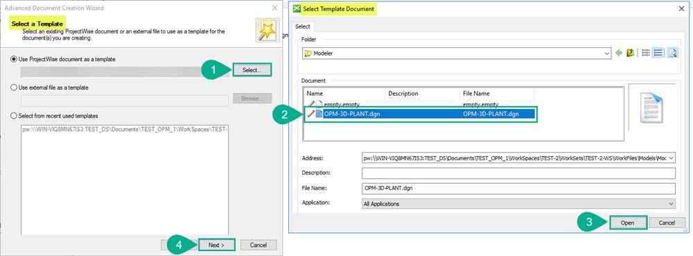

  8. To select the template file, click on select > select template file > Open & Hit Next as shown
    Note: One can browse to any other folder to choose the template document.

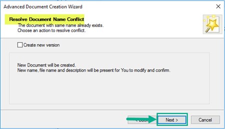

  9. Hit next on the resolve document name conflict dialogue as shown.
    Note: If we check on the create a new version, this meant that the Name, Filename & Description of existing documents are preserved.

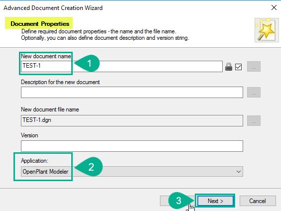

  10. Enter the desired name, description (if needed), select Application & click on next as shown

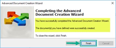

  12. Click finish on the successful document creation dialogue as shown
  13. As shown, the new file is created in the folder successfully.
