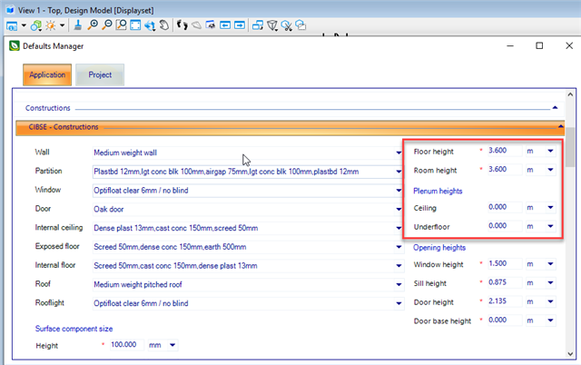

The default height settings for Plenums can be set when tracing rooms, or can be found in your Data Managers > Defaults menu.
Method
In nearly all cases Floor height and Room height should be equal (ie set to the height of the room), resulting in a plenum height of 0m.
Plenums should only be modelled as rooms if there is a specific need to do so - i.e. if they are conditioned/occupied rooms maintained at a particular temperature. If not, they should not be created.
