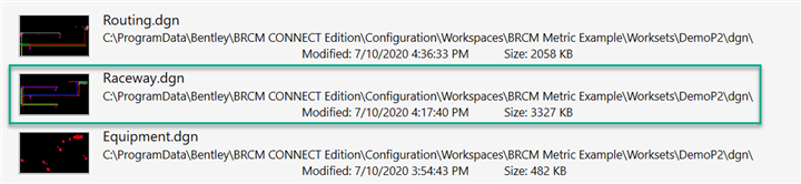

1.Launch the application and open a Raceway DGN file.

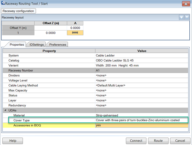

2. Route a raceway which has the UDA assigned. In this instance we route a raceway having Cover type as the UDA defined. To create a custom Raceway UDA you can refer this link.

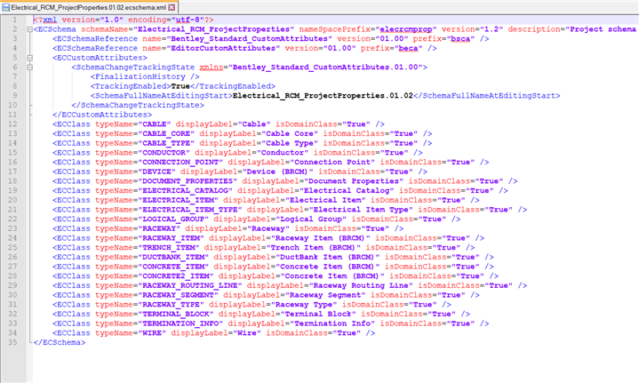

Go to C:\ProgramData\Bentley\BRCM CONNECT Edition\Configuration\Workspaces\BRCM Metric Example\Standards\BRCM\std_dataset\schemas and open Electrical_RCM_ProjectProperties.01.02.ecschema.xml schema file.
4.In the Electrical_RCM_ProjectProperties.01.02.ecschema.xml file find the following line-
<ECClass typeName="RACEWAY_ITEM" displayLabel="Raceway Item (BRCM)" isDomainClass="True" />
and change it to-

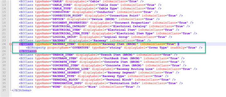

<ECClass typeName="RACEWAY_ITEM" displayLabel="Raceway Item (BRCM)" isDomainClass="True">
 5.Under the above line add the following line-
<ECProperty propertyName="COVERTYPE" typeName="string" displayLabel="Cover Type" readOnly="True" />
</ECClass>
  The resulting edit will be as displayed-
Note- The UDA name should be in Capital Letters and should contain any spaces.

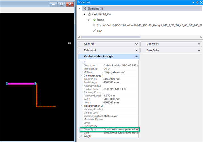

7. Route a new raceway with the corresponding UDA and the UDA will be displayed in the element information.

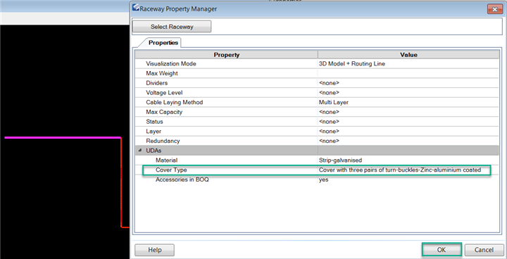

Note-  For the UDA values to be displayed for the raceway, which is already routed, select the raceway go to Raceway Properties. Select the UDA and Click Ok. The UDA will be displayed on element information.
8. The raceway UDA will be displayed on element information or element properties.
