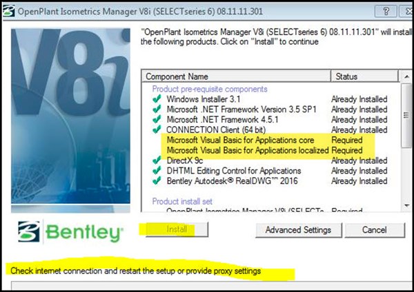

While installation of OpenPlant Isometrics Manager, user may face problem in downloading
Microsoft Visual Basic for Application Core
Microsoft Visual Basic for Application Core Localized
Error message will pop ups
“Check Internet connection and restart the setup or provide proxy settings”

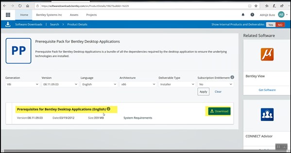

Install Bentley Prerequisites pack for Bentley Desktop Application. Before installation of OpenPlant Isometrics Manager.
  1. Go to following link:
    https://softwaredownloads.bentley.com/en/ProductDetails/1962?buildid=16229
  1. Download Bentley Prerequisites pack for Bentley Desktop Application
