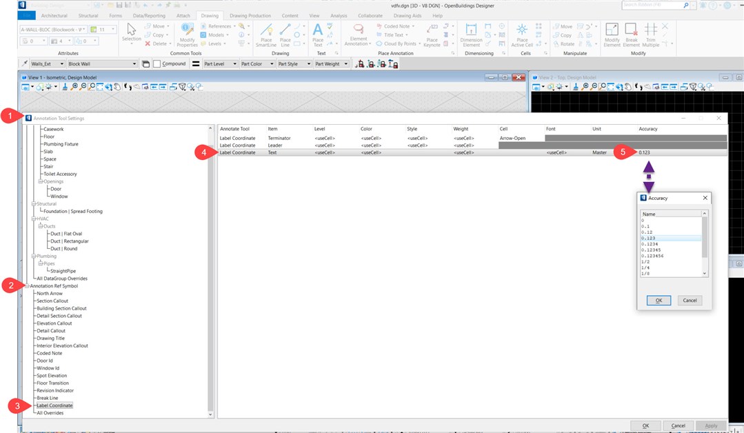

How to set accuracy for Label Coordinate
Below is the workflow that needs to be followed to change the accuracy of the label coordinate

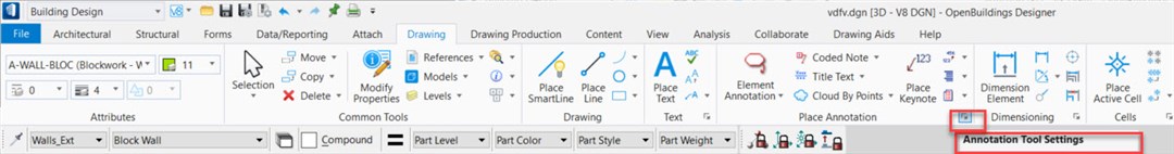

  1. Go to the Building Design > Drawing > Place Annotation > and click on the Annotation Tool Settings.
  2. Inside Annotation Tool Settings, go to the Annotation Ref Symbol > Label Coordinate > Text item > Accuracy to change the decimal points accordingly.
Afterward, we can see that the decimal point is been changed to three decimals.
