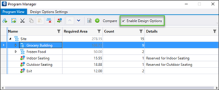

Design Options
- Design Options tool allows you to create multiple layouts based on the original program supporting the enable/disable option in the Program Manager dialog.
- Performing backward compatibility for design options is possible by enabling/disabling design options.

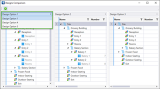

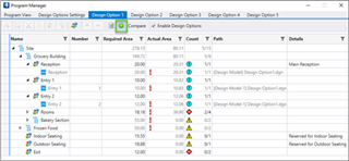

- Design Options Settings allows you to add two or more design option files to validate and compare the Required Area, Actual Area, and Count results. You can select existing files, create new files and also create a copy of the selected design option file by using the Duplicate option.
- Comparison of multiple design option files can be done by selecting Compare option in the Program Manager dialog and then comparing the desired design option files from the Design Comparison dialog.
- Validation of design option files can be done by selecting Toggle Validation On\Off in the Program Manager or Design Comparison dialog.

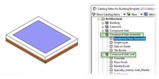

Compound Slab
- The Compound Slab Catalog Type has been split into two separate types: Compound Slab Assembly and Compound Slab Leaf.
- The Compound Slab Assembly is a catalog type that contains the layer properties which controls the general contents of the Compound Slab.
- The Compound Slab Leaf is a simplified type that refers to a single leaf element in the Compound Slab. Each leaf element has its own Object Classification, Identity, Fire Resistance Rating, etc.
- You can upgrade legacy slab and slabs created in update 9 with Upgrade Utility that creates a new Catalog Item for CompoundSlabAssembly and CompoundSlabLeaf if it is not already present in the catalog item list. Penetrations are also retained and upgraded in compound slab.

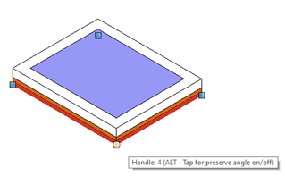

- You can modify an individual leaf or the whole compound slab assembly using the Modify Properties.
- You can modify the compound slab assembly by selecting the base region edit handles that appear on the selected core layer.
