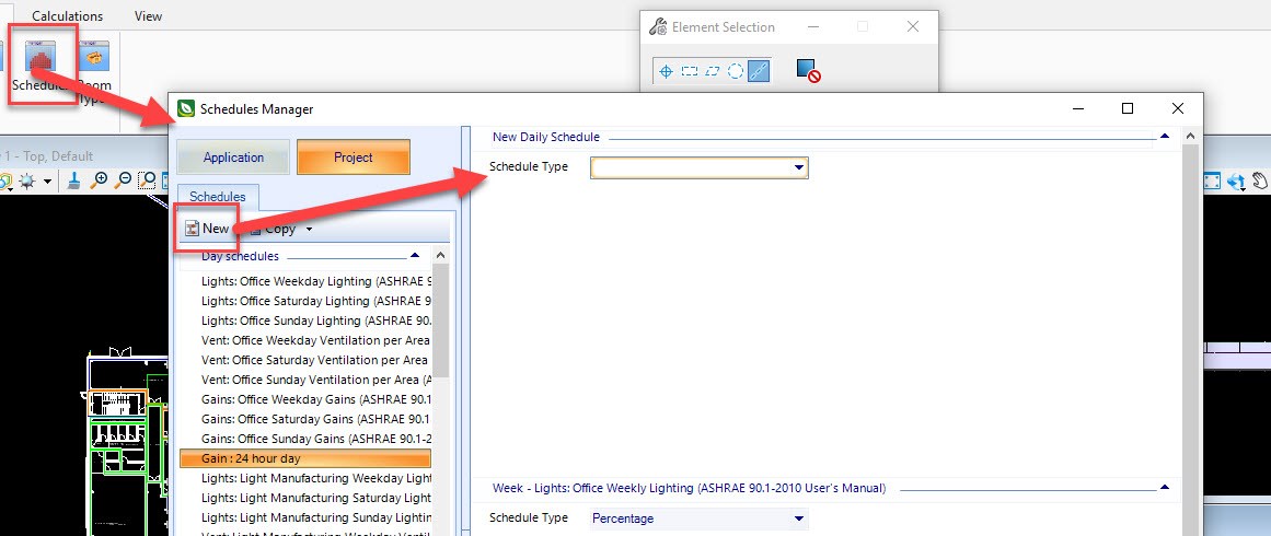

To manage schedules according to requirement, choose Data Managers > Schedules.
The Schedule Manager window will open where we can find a list of existing Schedules prescribed by the software on the left side of the window. Based on the design requirement, one can choose any of the schedules already available.
If there is a need to create a Schedule, one can click on the New button as shown in the image below.
There are five options available in the Schedule Type drop-down list; On/Off, Percentage, Value, Temperature and Control respectively. One can design their schedule choosing the most appropriate schedule type based on the requirement. Note that Daily, Weekly and Yearly schedules can be created sequentially keeping the same schedule type.

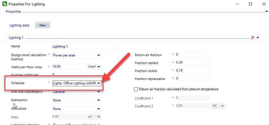

Once the schedule is created, one can apply the same for the components of a room; e.g., Lighting, Occupancy or Infiltration, from the project tree by choosing the properties of the components as shown below :
