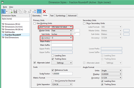

Can I round off fractional dimensions so that instead of seeing 32'-5 11/16" I would get 32'-6", or instead of 32'-2 1/4" I would see 32'-2"?
Yes, you can accomplish this by setting the Accuracy to "0" with Label Format still set to “MU Label-Sub Label” in the Dimension Styles dialog:

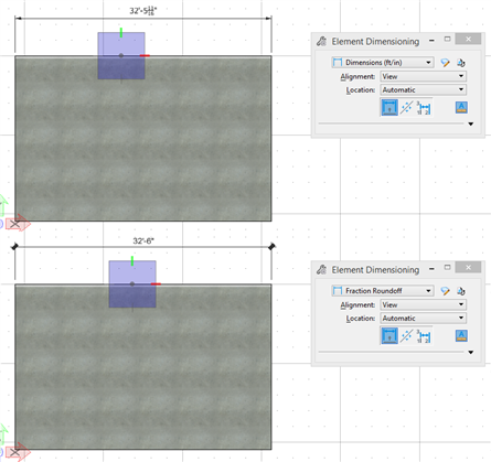

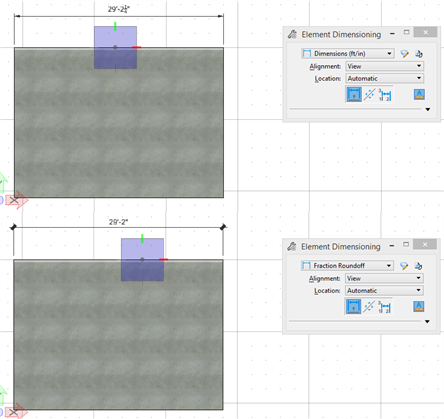

These are the results when comparing the delivered "Dimensions (ft/in)" dimension style to our custom version:
