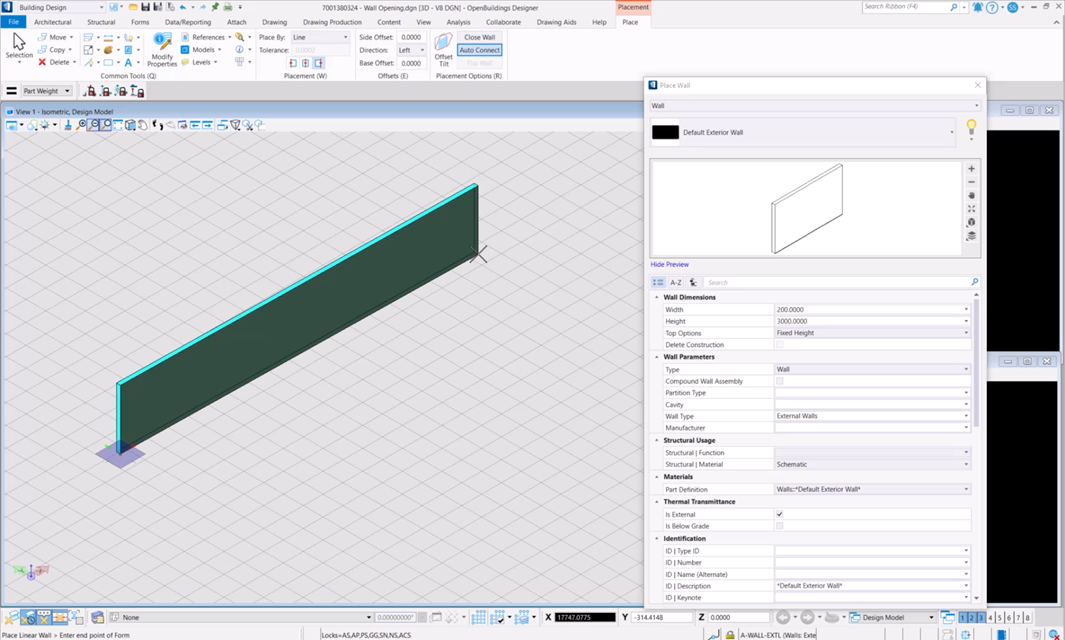

1. Place a wall in the model.

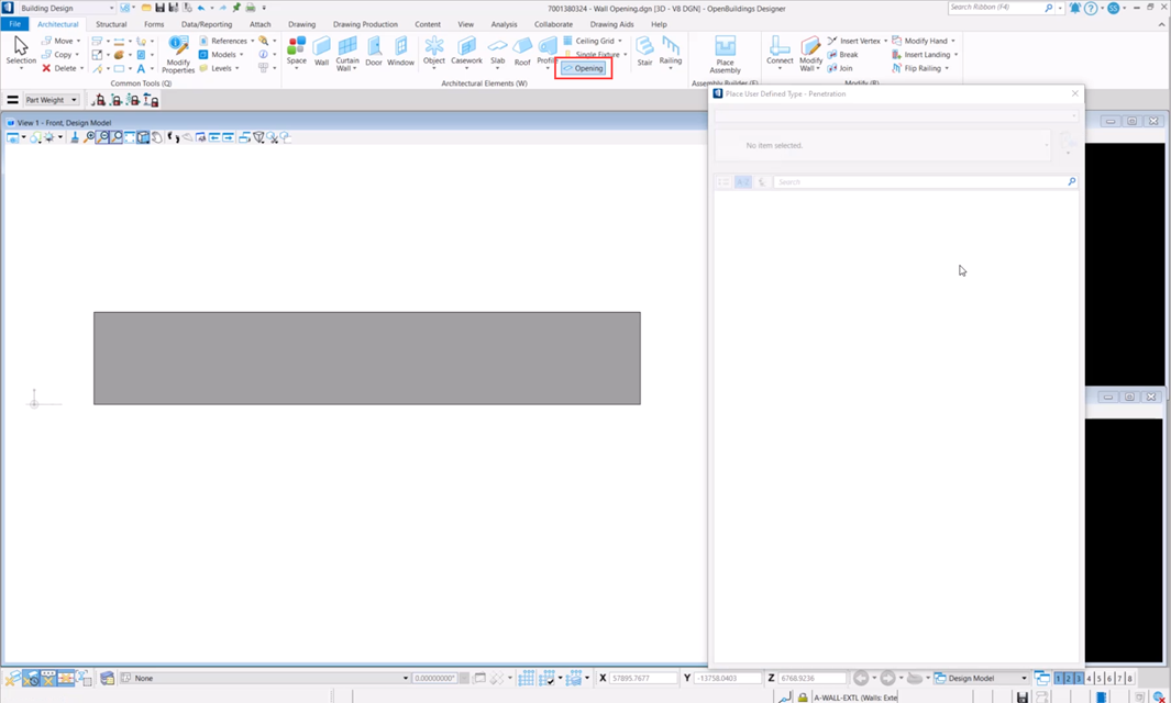

2. Then click on the Opening tool from the Architectural Elements tool group.

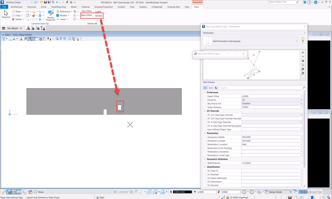

3. Next, define an appropriate Base Offset value in order to place the opening at the required height.
