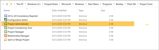

1.Open the Project Administrator

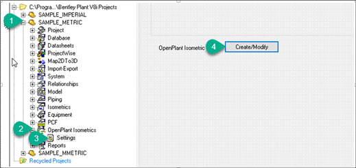

2.Navigate to the Project and launch the Isometrics configuration dialog

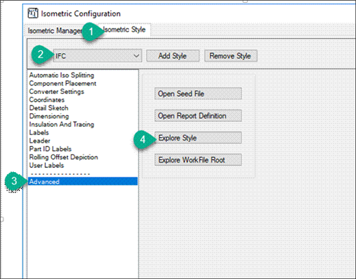

3.From Isometric configuration, click on Explore Style

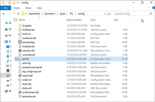

4.In the style, navigate to pcf.ini file

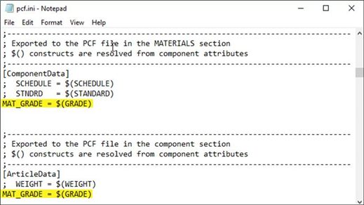

5.Open the pcf.ini file and add the Material Grade Property.
6.Save and close the file

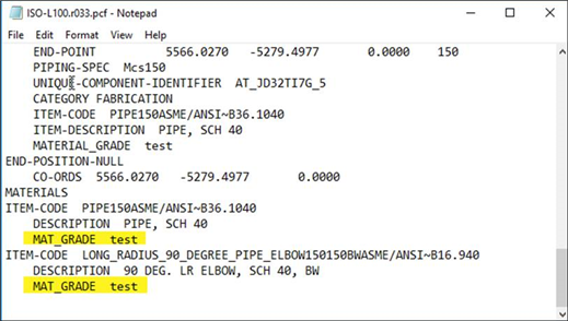

7.Generate the Isometrics
8.Open the PCF file, MAT_GRADE attribute will be available in the ITEM-CODE section.
