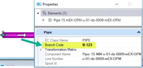

As an example, will see how to hide a default property “BRANCH CODE”. Attached the snap below before hiding a property.

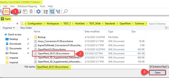

  1. Launch Bentley Class Editor.
  2. Navigate to the below-highlighted folder location of your desired workset. Select OpenPlant_3D.01.08.ecschema & click on Open to load this schema.

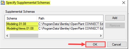

  3. Supplement the schemas OpenPlant_3D_Supplemental_Modelling & OpenPlant_3D_Supplemental_Modelling views as shown

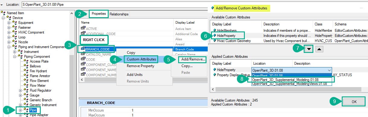

  4. Navigate to Pipe class, properties & on BRANCH_CODE property add “Hide Property” as a custom attribute as shown
    Note: One can navigate to any other class & property for the same.
  5. Make the fields True for both 2D & 3D as shown
  6. Save all changes.

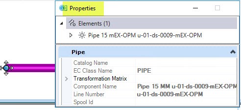

  7. Place a Pipe & check the results as shown
    Notice that, the Branch_Code property is hidden now as compared to the initial case.
