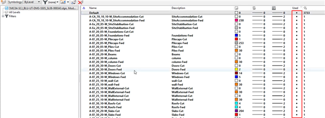

How to remove unused active levels from the Level Manager as shown in the screengrab below?

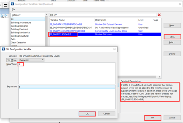

Please refer to the below steps through which you can easily remove the unused active levels from the Level Manager.
  1. At first, please go to your Configuration Variables tool and search for “BB_DVLEVELSDISABLE” config variable.
  2. Upon finding the variable edit it and set the value as “1” and save it as shown in the screengrab below.

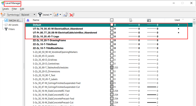

  1. After setting the variable close your OBD session and restart it again.
  2. Finally, after restarting when you will open your Level Manager you can see that only the actual active levels in the model are visible in the Level Manager.
