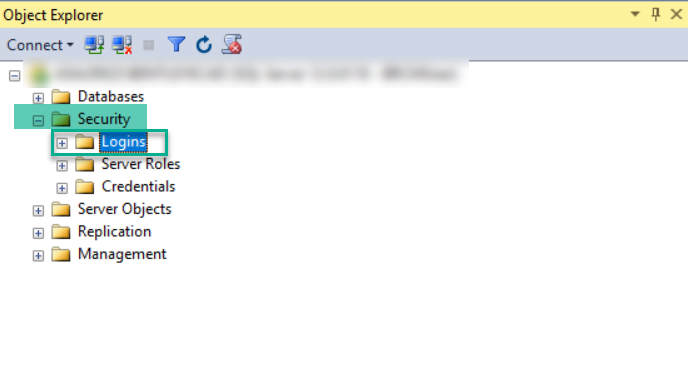

1. Launch the SQL Server Management Studio and connect to the server.
2. In the Object Explorer tree expand Security and then expand Logins.
3. Create the login if does not exists.
4.Right Click the login and select Properties.

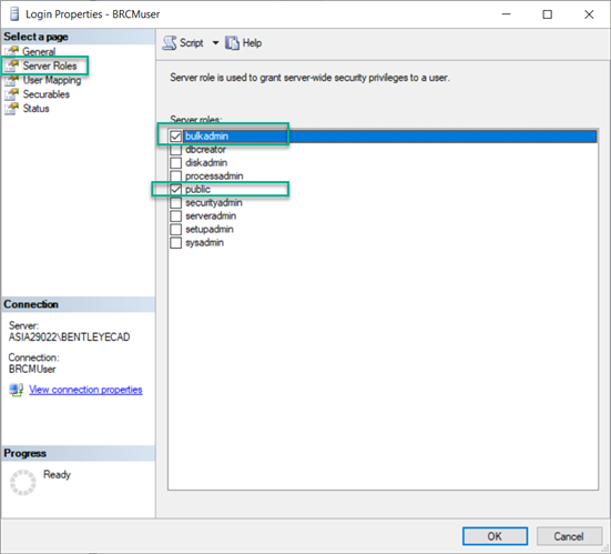

5.On the Server Roles page enable the following:
-bulkadmin
-public
6.On the User Mapping page, select the database used by the application and specify ‘dbo’ in the default schema column.
7. In the Database role membership area enable:
-db_datareader
-db_datawriter
-ddl_admin
-public
Or enable:
-db_owner
-public
disable:
-db_denydatareader
_db_denydatawriter
8. Click Ok. The minimum SQL user permissions are configured.
