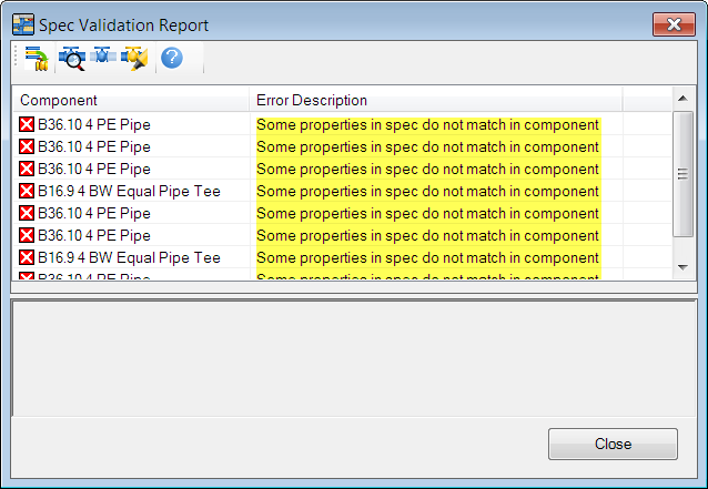

While Validating spec, newly added property report error 'Some Properties in Spec Do Not Match in Component'. See image below.
To get it implemented, below steps will describe, adding a new property in Schemas, mapping its property to enable it to fetch the information from specs and display it on its attribute fields in OpenPlant Modeler. Adding the attribute to Configuration variable will get it checked during the time of spec validation. Below exercise has been created to explain it further.

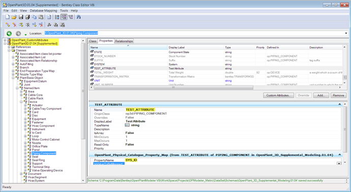

  4. In class editor, open OpenPlant_CustomAttributes.08.11.ecschema.xml schema. This will enable to get the custom Attribute OpenPlant_Physical_Catalogue_Property_Map from it.
  5. Again open OpenPlant_3D.01.04.ecschema.xml schema.
  6. Supplement it with OpenPlant_3D_Supplemental_Modeling.01.04.ecschema.xml schema.
  7. Navigate to Piping Component class and create a property TEST_ATTRIBUTE.
  8. Add Custom Attribute OpenPlant_Physical_Catalogue_Property_Map to above property created. See image below.

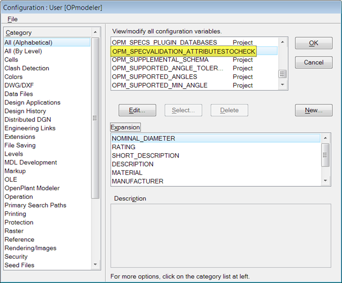

  9. Open Configuration dialog box through Workspace option present in main menu and search for variable OPM_SPECVALIDATION_ATTRIBUTESTOCHECK. See image below.

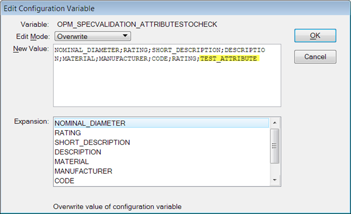

  10. Edit the variable and add new attribute TEST_ATTRIBUTE to enable a check during spec validation process.
  11. Select OK and save settings.

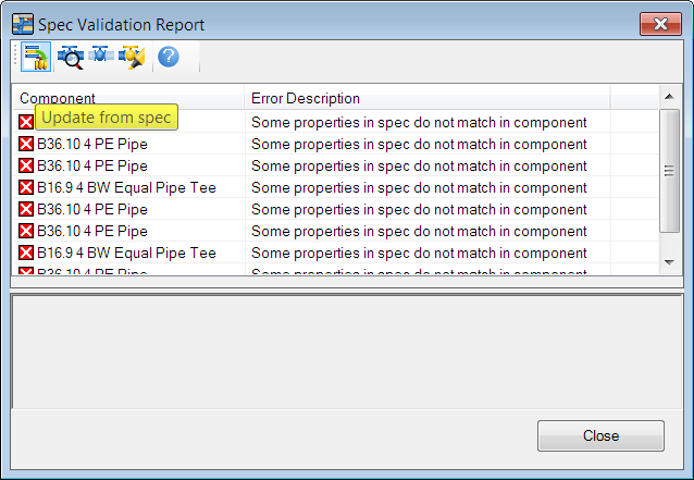

  12. Launch OpenPlant Modeler, Open Pipeline Manager and do the spec Validation.
  13. Existing components and fittings will be reported as Inconsistent. See image below.
  14. Click on Update spec option. This will update the new attribute to existing components.
