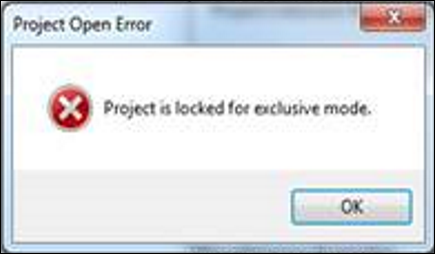

Project is Locked for Exclusive Mode Error Appears when opening Project in Project Administrator
Product(s):AutoPLANT Modeler CONNECT Edition
Version(s):10.02.00.48
Environment:Windows 10 (64 bit)
Area:Error, Logs, Messages, Crashes
Subarea:
Original Author:Abhijeet Shinde, Bentley Product Advantage Group
In AutoPLANT Modeler, when user tried to open the project in Project Administrator then user may face below error message.
This issue is most likely occurs when user has insufficient permissions and some restrictions on Plant V8i folder.
This wiki article explains the steps to help resolve this issue.
Steps to Resolve
AutoPLANT User needs to grant the permissions to below mentioned folders:
1.\Program Data \ Bentley
2.\ Program Files (x86)\Bentley
3.\Program Files\Common Files\Bentley Shared
 The error message appears to have gone after granted permissions to above mentioned folders.
