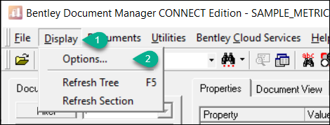

1.In Document Manager, Go to Display > Options to display the Display Options dialog

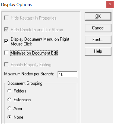

2.Type the appropriate value within the Maximum Nodes per Branch field, then press OK.
3.Setting the maximum allowable records per branch from the Display Options dialog applies to all tabs displayed in the Document Manager.
