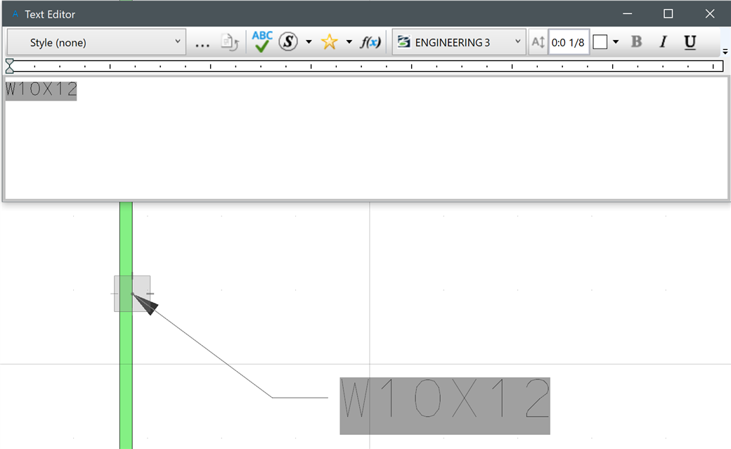

1. From the Text dialog choose the Insert Field option, and in the Place Note dialog enable the Association locks:
2. Choose the desired Dimension Style to set the Leader options along with the applicable placement and orientation settings:
3. Next, choose Element Properties from the drop-down list and click on the OK button, then select the element to be annotated:
4. Finally, from the Fields Editor dialog choose the desired DataGroup property and place your annotated property value with the desired leader settings:
