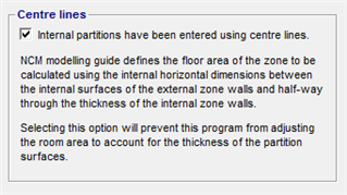

Typically rooms are entered using the internal edge of room surfaces. However the NCM Modelling Guide requires the floor area to be calculated to the centreline of internal partitions.
The Centre line option (under the General > Other tab) caters for tracing rooms using either:
Partition Centre lines
Or
Internal partition edges
Care should be taken in selecting the correct method as this will have implications on room areas.
