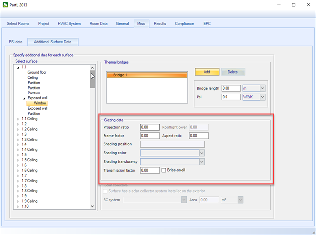

This information can be entered under the "Misc." page in PartL, on the "Additional surface data" tab.
Once a Window is selected from the Select surface list as above, the Glazing data input becomes active.

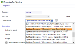

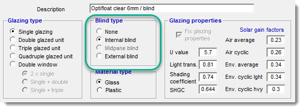

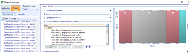

The Shading position, Shading Color and Shading Translucency will only become available if the window selected has a glazing type which includes a blind. This will depend on the make up of your glazing construction, in the Materials Manager.
For example a window including blind could be selected as below:
Or alternatively, please ensure to add a layer for the blind as below:

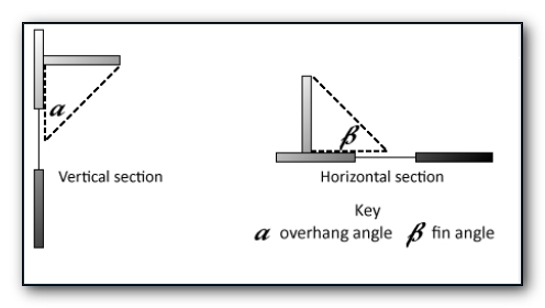

Figure 43: Shading from overhangs and fins
For the purpose of this calcualtion, the angles alpha and beta (dashed lines) are taken between
the plane of the window and overhand of fin shadow at mid window.

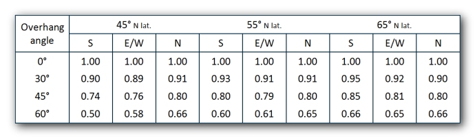

Table 10: Partial shading correction for overhang, Fo
Table 11: Partial shading correction for overhang, Ff
