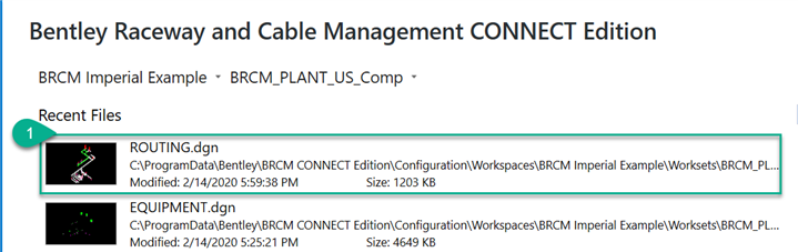

1. Launch the application and open Routing DGN file.
Note: Open an already routed DGN file. For detailed steps to perform automatic routing refer to this link.

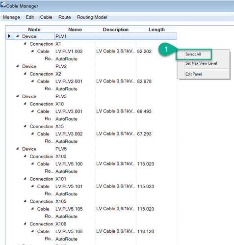

2. In Equipment & Cable tab , open the Cable Manager.
3.In the cable manager right click and select all the cables.

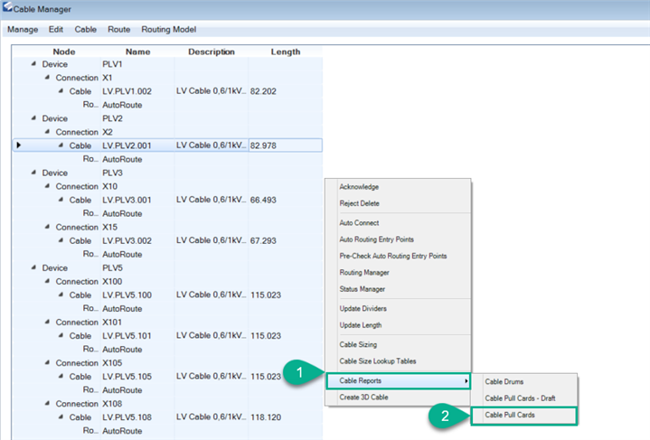

4. Right Click and go to Cable Reports and select Cable Pull Cards.

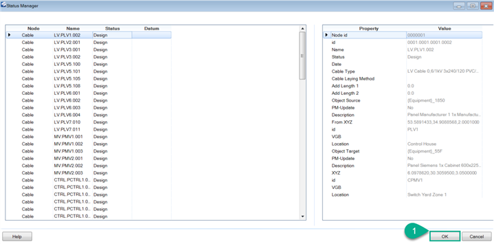

5.The Status Manager dialog opens displaying the status of all the cables. Click Ok.

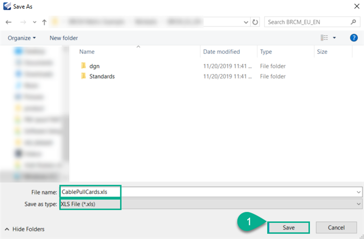

6.A dialog box to save the cable pull card report will be displayed. Click on Save to save the cable pull card as XLS file.
7.The Excel (XLS) file of the cable pull card report will be generated and it will show the Cable Drum Number.
