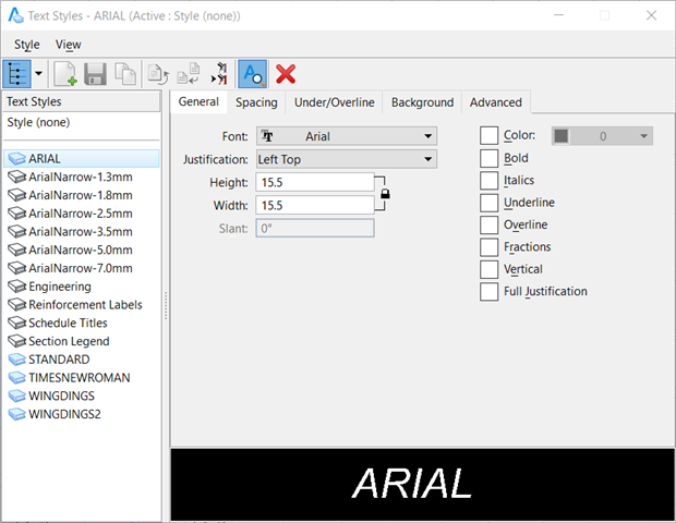

Texts are becoming Italic in Text Style dialog
  Product(s): OpenBuildings Designer
  Version(s):
CONNECT Edition & 2023
  Environment: N/A
  Area: Annotation
When placing a text in Arial Font Style, it is showing as Italic. All the placed text in Arial has also changed to Arial Italic even when Italics is not checked in the Text Styles dialog.
The issue occurs because the Arial Regular Font TrueType font file (.ttf) is missing in the C:\Windows\Fonts\Arial folder.
Add the Arial Regular.ttf file in the directory and relaunch OBD. This will update the existing texts in the models and all succeeding added text should be in the correct font style.
