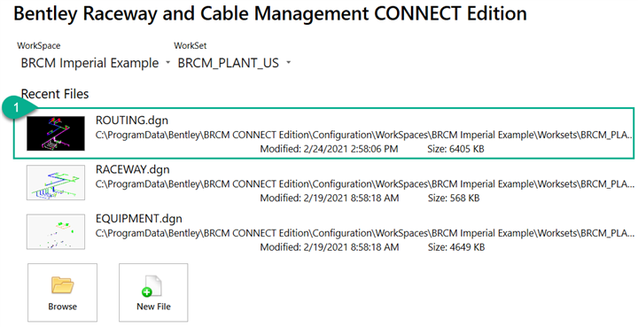

1. Launch the application and open Routing DGN file.
Note: Open an already routed DGN file. For detailed steps to perform automatic routing refer to this link.

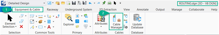

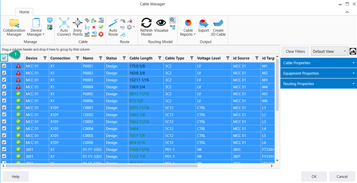

2.In Equipment & Cable tab , open the Cable Manager.

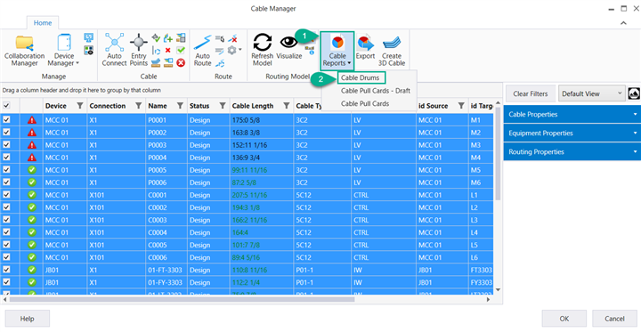

3.In the cable manager select all the cables using the checkbox at the topmost row.
4.From the Output ribbon group in the ribbon menu, Click on Cable Reports and select Cable Drums.

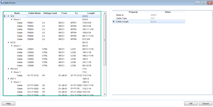

5.The Cable Drums list will be displayed. Click Ok.

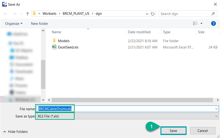

6.A dialog box to save the cable drum report will be displayed. Click on Save to save the cable drum report as XLS file to the desired location.

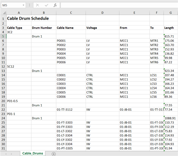

7.The Excel (XLS) file of the cable drum report will be generated.
